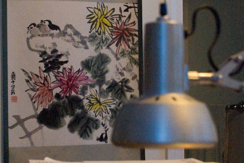

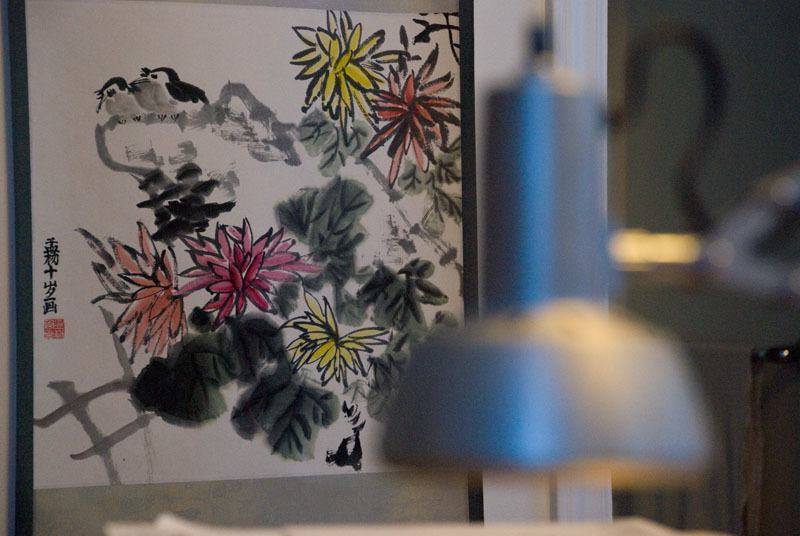

I put my camera on a tripod and set up a scene with a desk lamp about 0.6 m away, and a painting on the wall about 2.5 m away. I took two shots with the lens zoomed to focal lengths of about 24mm and 75mm. This is with a Nikon D80 that has a sensor a factor of 1.6 smaller than 35mm film, so its "normal" focal length is about 35mm.
The original picture shot at 24mm of course has a much wider field of view. I cropped it in Photoshop to match the other one fairly closely for comparison, and scaled both of them to the same size. The relative sizes of the lamp and the painting are almost the same in both pictures. I think the small difference is related to the fact that the front of the lens moves about 40 mm when I zoom between the two focal lengths, so the effective location of the camera is probably slightly different in the two pictures.
The 24mm shot does have greater depth of field (the lamp isn't as blurred), and it shows more image noise because I had to enlarge it by a factor of about 3x before cropping it. (I set the camera to ISO 800 so I wouldn't have to use flash, so there's much more noise than I normally get in pictures from this camera.)

There are people here talking past each other. When you have to capture a subject and you want the image to subtend a reasonable angle at the focal plane (a critical part of composing your subject), you have to choose your focal length and distance to accomplish this. If you try to create a portrait of a person with a 28mm lens, the person's face going to be very distorted. You can preserve perspective by shooting the portrait from very far away, but that surely ruins the concept of shooting portraits because the subject's image will be very small on the film. There goes the composition.
In the days of film photography, photographers were constrained by film speed and film grain, and there were limited choices of emulsions. Creating attractive images with such gear meant choosing focal lengths and subject distances that would minimize the distortions caused by perspective. There are related constraints today, but those have been softened a bit by digital cameras' ability to change ISO. Still, you can't take an image of a distant object with a short focal length and enlarge it with sufficient quality to approximate the quality and lack of perspective distortion that you can achieve with a longer focal length.
Exactly. I agree. Now you can see why it's nonsense when people confound focal length with 'flatteringness'. Experienced photographers (who really should know better) will swear blind that you simply can't shoot a portrait with a wide angle lens, no matter what. They attribute some mysterious perspective distortion characteristic to wide angle lenses.
They of course talk rubbish. Wide angle lenses see the same perspective as telephotos. To claim otherwise makes no sense. Perspective is controlled by your feet, not your lens. Your lens may influence where you put your feet, so there is an association, but there is no inherent optical causality between focal length and perspective. Many will swear blind that there is.

The 24mm shot does have greater depth of field...
This surprises me and I knew we could get to circles-of-confusion sooner or later. Just like the perspective brou-haha, depth of field should be a function of relative angle as well. As you blow up a wide-angle frame the same relationship between distance and fuzzyness (based on the resolution of the eye, etc) should hold.
