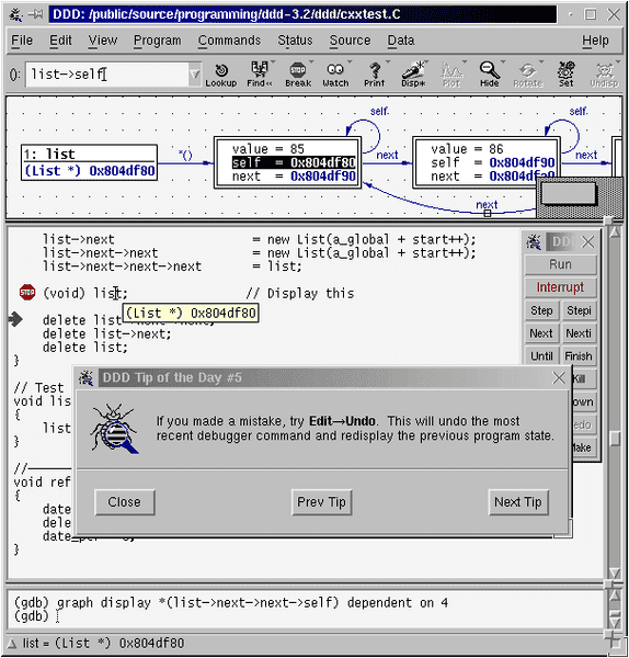

This is specific to unix/linux, but when I debug code I use a combination of printf statements as well as compiling the program with a -g option in gcc and then using DDD to trace variables and such.
http://www.gnu.org/software/ddd/
ddd is really nice for tracking linked lists because it will actually show you graphically how the nodes are linked and what information they contain.
That's very nice, does it do other data structures, like trees?
Yeah, it can handle pretty much any data structure you feed it.
Here is an example of trees (I've had to scale it down a lot because of my 1600x1200 resolution:
