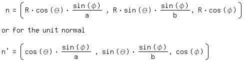

Hello!
I am trying to find the normal to an ellipsoid of the form
[tex]x^2/a^2 + y^2/b^2 + z^2 = 1[/tex]
What I did is the following: Let
[tex]psi = x^2/a^2 + y^2/b^2 + z^2[/tex]
then grad psi (and thus the normal) is:
[tex]grad (psi) = (2x/a^2, 2y/b^2, 2z) = n[/tex]
Could anyone tell me whether that is the correct approach to find the normal to an ellipsoid? Thanks a lot!
Well, I'd have to work it out to tell you for sure...
But I have a better idea: I could try to help you figure out how to work it out to tell for sure. :smile:
The very first thing I'd do is to see if it's consistent with things I know. Are there any ellipsoids whose normals you already know? For for a general ellipsoid, are there any points for which you already know the normal vector?
The next thing I would do is to try and verify that it satisfies the definition of a normal vector: do you know how to find tangent vectors to your ellipsoid? (Or even better, how to find the tangent plane?) If so, you could then test to see if your alledged normal vector is, in fact, perpendicular to the tangent vectors.
Well, if a = b =1 then it would simply be a sphere, wouldn't it? And for a sphere the normal vector is simply the vector x of a point lying on the surface of the sphere.
Wouldn't that be the case for an ellipsoid as well?
i.e. a point on its surface is the normal vector at that point? I calculated the normal vector this way in spherical polar coordinates (see attached file).
However, that is different from what a got by using the gradient function. So, which one would be right and why?

Just a thought but couldn't you parameterise your ellipsoid using the 'usual' two variable parameterisation of a unit sphere but with an extra factor of a (or b) for the x and y components. eg. instead of writing x = sinucosv, let x = asinucosv. Similarly let y = bsinusinv and z = cosu. Using these substitutions, (x/a)^2 + (y/b)^2 + z^2 = 1 as expected.
[tex] \Phi \left( {u,v} \right) = \left( {a\sin u\cos v,b\sin u\sin u,\cos u} \right)[/tex]
Find the derivatives of the above wrt u and v, cross them and that should be the normal if I haven't neglected anything. (I haven't checked that method, it's just something I came up with off the top of my head).
At a point on the surface, the normal is perpendicular to the tangent plane.
At a point on a circle (or sphere), the tangent vectors are perpendicular to the radial position vectors (since the magnitude of the radius is constant on the circle). So, in this case, the normal and radius vectors are parallel.
Will this be true for an ellipsoid?

As Robphy said, your original approach is correct.
thanks very much! Those links are really good and helped me to see that the vetor of an arbitrary point on an ellipsoid is NOT equal to its normal at that point! :smile:
