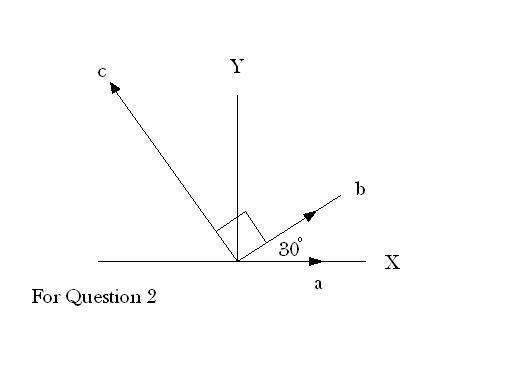

2.The three vectors shown below, have magnitudes a=3.00, b=4.00 and c=10.0. a) Calculate the x and y components of these vectors. b) Find the numbers p and q such that c= pa + qb.
Are you ok with calculating the x and y components? This simply uses the diagram and the definitions of sin and cos.
For the second part, I am assuming that p and q must be integers? (otherwise, there is an infinite number of solutions). Here the numbers are so simple that one can see the solution just by trial and error very quickly. I am not sure if they want you to do it in a certain way.

[/quote]2.The three vectors shown below, have magnitudes a=3.00, b=4.00 and c=10.0. a) Calculate the x and y components of these vectors. b) Find the numbers p and q such that c= pa + qb.
I have been doing research on google and Wiki for probably three hrs and i stil don't know anything about it.(I'm sorry, pls help, I'm just too dumb for it.:rolleyes: )[/quote]
"The three vectors shown below"?? Where? Presumably, you are given some information about them that you can use together with the fact that, for a, [itex]x^2+ y^2= 9[/itex], for b,[itex]x^2+ y^2= 16[/itex] and, for c, [itex]x^2+ y^2= 100[/itex].

Hey thanks a lot for ur help HallsofIvy, that really gave me a lot of info to finish my HW(wel havn't yet), "The three vectors shown below" is in the picture @ the bottom of my post. Thanks a lot again anyway.
