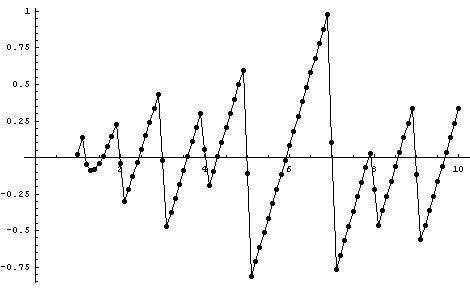

Just though I'd mention how to read into Mathematica, the first 100000 imaginary components of the zeta zeros from Odlyzko's site:
http://www.dtc.umn.edu/~odlyzko/zeta_tables/zeros1
First cut and paste the list to a *.txt file. Then use the code below, changing of course the location of where you put the file:
Code:
(* set up path to read in zeta zeros from file *)
$Path = Append[$Path, "c:\Math\pf forum 4"];
(* now read in zeros *)
zlist = ReadList["zetazeros.txt", Number];
Keep in mind the list is only the imaginary components of [itex]\rho[/itex] and not [itex]\overline{\rho}[/itex]. Anyway, I did this and computed the zero sum of von Mangoldt's formula in order to exhibit the discontinuity of the series at powers of primes. Note the plot below. The sum needs to be done symmetrically (both [itex]\rho[/itex] and [itex]\overline{\rho}[/itex] together before going to the next one.

saltydog said:
Pretty sure that's right. Kindly correct if not.
Looks fine. Dealing with this [tex]\psi_{0}[/tex] is often skipped by making a statement about [tex]\psi(x)[/tex] that's valid when "x is half an odd integer", or some such dodge.
I'm sure you've also plotted the truncated explicit formula vs. the von mangoldt function itself? It's kind of neat to see just how well it follows the step shape for a given number of zeros before being drowned out by the main term.
