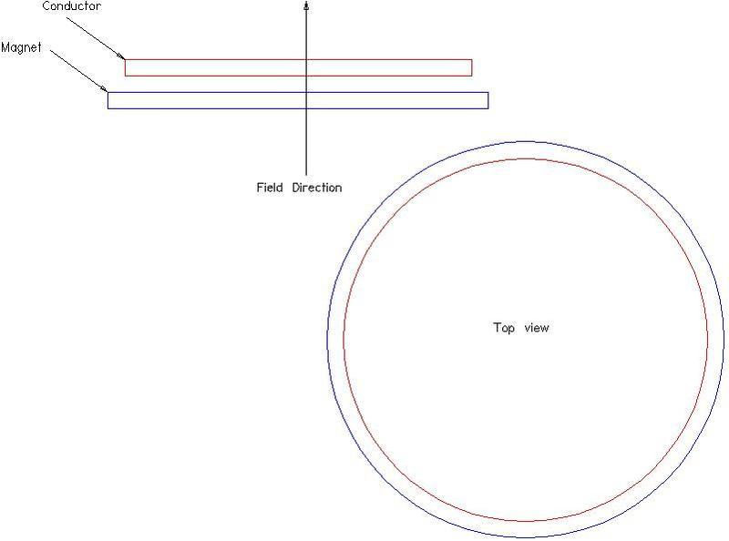

I am currently conducting preliminary experiments with the Homopolar design. The purpose is to try and establish the how and why it behaves the way it does. An example of a one of the main phenomena displayed by this method of producing electricity is the simple fact that it does so in a uniform magnetic field. Current induction laws as I understand them require a changing magnetic field to induce a current in any given conductor. Another interesting phenomena is the fact (and I have proven this with first hand experimenting) is that you can fix the magnet to the conductor and still produce a current in the conductor. Apparently the field is independent of the magnet as is theorized by some affluent physicists.
I currently have measured results from a simple homopolar design I am using to experiment with. The results show consistent results. Some of the standard proof of principle results are as follows:
1. symmetrical increase in voltage and amperage with an increase in armature RPMs
2. reversing nodes reverses polarity
3. reversing angular direction of the armature reverses polarity
4. continuity between drive mechanism and experimental peace is zero
5. providing a second induction magnet to the peace increases both voltage and amperage out put.
Now all that being said (written). The particular peace I am experimenting with is producing almost twice the voltage as it does amperage. I understand that typical designs produce much more amperage than voltage so I have found myself a bit of an odd result in my experiments. I would like to discuss the exact nature of my experimental peace but truly if I have found something rare in this design I should try to protect it.
So I put to you these two questions. What do you think would cause a high voltage low amperage result? And has anyone out there every experimented with this design?
Thanks in advance for your response

I've had experience with the theory. I used an HPG concept in an electrical propulsion design. It is basically a moving 'conductor' in a static magnetic field (usually, although one can increase the magnetic field to increase the EMF and current). A moving conductor in a magnetic field experiences an EMF - Lorentz force effect.
The homopolar generator allows for 'continual' movement of the conductor in one direction.
Reversing the direction of the field reverse the EMF or polarity, although I am not sure why one would want to do this.
The EMF is generated between the outer surface and inner axis. Using an HPG, one puts an electrical contact (pickup) on the circumference of the conducting disc (OD) and another on the conducting axis or as close to center of the disc. Then one can put a load between the contacts.
What does one mean by high voltage? HPG's voltages are usually low, e.g. on the 100 V or so.
Low current means high resistance/impedance load, or low HPG rotational speed, or low magnetic field.
Don't know anything about this configuration.
It's one I havn't seen.
Define high voltage.
Low current = small load, disk very thin or bad contactor design.

Looking at my last post there is an attachment that illustrates the general design layout. The arrangement I am referring to consists of physically fixing the conducting disk to the magnetic disk as they are illustrated in my attachment. By doing this both the conductor and inductor spin on the same axis at the same angular velocity creating a measurable current in the conductor. Literary grace is not one of my strong points so I hope you understand my explanation and I apologize if you don’t.

My reference to high voltage is a relative reference. The measurements that I took on my test piece showed 1.5 times more voltage than amperage when measured at any particular RPM. I understood and this may be my misunderstanding, that I should produce a much lower voltage than amperage when producing a current using a HPG. This in the end is why I am here. If I am not taking or reading my measurements correctly then now is a good time to find out.
Another good question to put forward is this. By fixing the inductor and conductor together what kind of resistance would one expect to impact the angular motion of the armature? As I see it only the physical friction in the system would impact the angular motion of the armature. If I am missing something please point it out.
I understood you quite well.
It's not a configuration I have seen.
Frankly, I would have to see it replicated.
The 1.5 times relationship is the load resistance.
Change the resistance, change the current.
E=IR and all of that.
What is the voltage?
Off the top, I would say any output current is getting generated in the frame of whatever it is you built.
Try it using a plastic or wood frame.
This is an exploded view of the piece I'm experimenting with. Current is measured from the conducting disk as described by Astronuc.
I am not sure if I understand electrical generation as I should. I am taking measurements from this experimental peace and interpreting them the same way I would if I took the same measurements from a battery. If there are other considerations I should be taking into account I would be grateful for your (anyone’s) direction on that matter.
