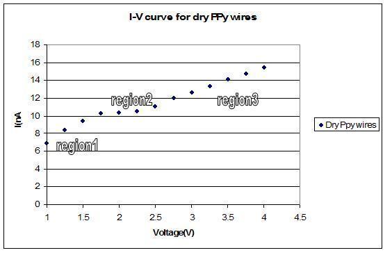

hey guys, I have an IV cure from which i need to develop a mass-spring damper model... can somebody help me with that.
the curve has basically a 3 slopee, each linear...
if somebody has any kinda idea abt this, i can post the curve as an image...
thanks

i have posted a curve that i have obtained from tests on a bunch of nanowires... i need to develop a spring-mass-damper system that best describes this curve...
the mechanical analogy for current i guess is Force and for voltage is Velocity, so this same curve is again a force vs velocity curve... so is it possbile to get a spring-mass-damper system from the curve?
I'm still not clear on the mechanical analogy thing, but before that, why is that plot not linear? How was that data gathered?
i guess the plot is not completely linear because this is how the nanowires behave... the data was gathered using a Keithley 4200, which is a semiconductor characterization system and a probe station

Fair enough. Why do you need to translate that into a spring paradim, or am I misinterpreting your question?
this is basically part of my research... nobody has researched the materials i have been working on... so now that we have some data and plots, we want to get an electrical model and also into a spring paradime... we want to investigate certain efeects that might be going on in the wires... like maybe a peizo electric effect... so that is why i need to develop those models
The intristic parameter you can recover from IV curve is R (resistance), which is simply V/I
The instristic parameter of a spring is of course the spring constant k.
Hooke's law is F = -k*x
so k = -F/x
Now you can substitute Volts (V) for Force (F) and current (I) for displacement (x)
That would model a non-linear spring, possible made from some weird alloys, because your data is non-linear.
BTW, this is one of many possible transformations. Whatever you do, you have to preserve R.
