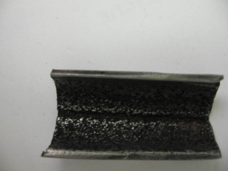

In heat exchanger (U-type) I've problem with erosion/corrosion at beginning of tubes in heat exchanger,near tube-sheet where steam enters.i suspect cavitation is problem. on tubes there's a channel of erosion in the middle of tube where material is gone and tube is very thin in that channel,as tube continues channel is smaller and smaller,and finally there is normal cross-section of tube.medium in tube is 4bar steam used for heating methanol in shell side
anyone had experience with this? how to try solve this problem?

here i am,
i study my exchanger and cut some tubes,so here's little drawing of my case and picture of part of damaged tube.
As you see, damage is on the inner part of tubes where steam goes,damaged tubes are tubes on top of bunddle and upper part of tubes at aproximately in the middle of tube.
i first thought about cavitation but as you said cavitation happens in liquids so now I'm not sure i can explain mechanism which cause that erosion
as you see from temperatures my steam is not superheated ,it's probably some mixture condensate/steam
my theory is :mixture of steam/condens. came in tubes,condens. flows in lower part of tube and in upper part of tube is steam,in the middle of tube length (pointed at picture) where methanol (in shell) has lower temp. bubbles of steam begin to colapse (turn in condensate) and in that process devastate tube,maybe tubes on top of bunndle and upper parts of that tubes are most exposed to methanol temp. so that's where most of that transition steam bubbles-condensate hapenns.
i hope i make thing clear ,if i forget answer or mention something feel free to ask
i think one of solutions would be different material of tubes or superheating steam
any suggestions?

middle of tubes means middle of length of tubes (middle of exchanger)(drawing)
If that eroded channel is on the top inside surface, you may very well be looking at a cavitation problem, as you suggested. That implies that the heat exchanger is doing almost all of its work (transferring the latent heat of vaporization) in that short little section of tubes near the product outlet pipe, and the remaining length of the tubes is carrying an almost solid plug flow of condensate. The tubes at the top of the bundle are exposed to the hottest flow of product, and the steam in them might not fully condense, carrying a mix of steam and condensate to the next chamber, where the steam bubbles collapse when they come into contact with the cooler tubes (surrounded by cooler product), resulting in erosion. That could be why you see the damage concentrated in the upper tubes just beyond the first baffle. I had assumed (wrongly) that you have a counter-flow heat exchanger that would minimize thermal shock, but from your drawing, the product flow is serpentine, and there is an area that is prone to thermal shock, right where the damage is concentrated. I am afraid that I don't see an obvious solution that doesn't involve re-engineering. Superheating the steam might just push the problem further downstream without solving it.
The most obvious solution would be to replace the heat exchanger with a vertically-mounted single-pass counter-flow unit. Steam enters the top, condensate exits the bottom, and product flows in at the bottom of the shell and exits from the top. This would minimize thermal shock and if cavitation did occur, it would not be confined to a small section of the tube interior, but would be evenly distributed.

it's actually heater of methanol,why this setup i really don't know,maybe because of higher pressure of steam than methanol,hmm you make me thing,what if i switch this(steam -shell,methanol -tubes)? i don't know
i just working on checking steam traps along pipes ,but i think it's not main problem cause steam bubbles that condense along tubes devastate tubes not the condensate wihich is not being removed by steam traps,just thinking

If the trap does not remove condensate fast enough, this plug will grow larger backing up into the exchanger and reduce the capacity of the exchanger. If this plug moves suddenly, the pressure in the tube drops and the condensate at the steam end of the plug flashes to steam, causing hammering. The steam trap should be working at or near steam temperature, if condensate is allowed to form in the exchanger to that degree, the trap is probably operating considerably below steam temperature. Condensate allowed to cool below steam temperature forms carbonic acid, which also eats and pits piping.
Your entire exchanger should be filled with steam, with condensate only forming near the trap end. This is all a function of the trap.
