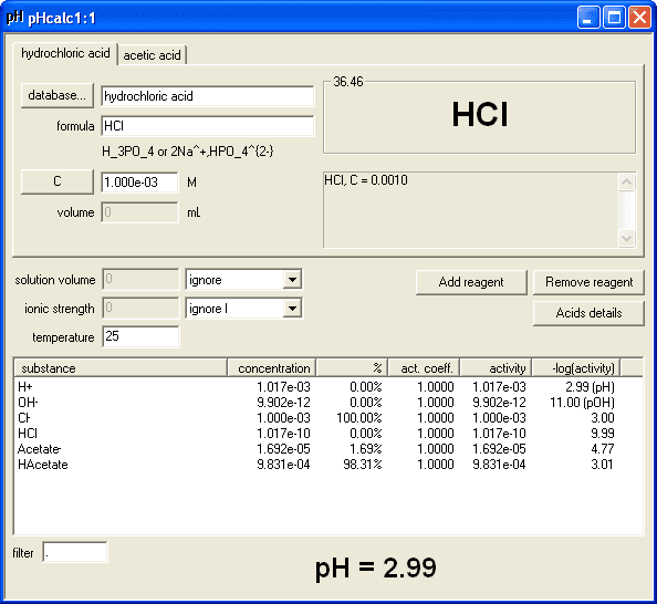

I think if you mix the two it will give you a pH almost the same as if you put the same volume of water as of weak acid, but will be very slightly more acid than that. In other words the effect is essentially no different from dilution.
Instead of complicating by dilution let us just compare a given concentration of strong acid with that same concentration of the strong acid but the solution also containing weak acid. (I am assuming the weak acid not extremely more concentrated than the weak.) Now it is true that, compared with when the weak acid was on its own, dissociated ions e.g. Ac- will take on protons to form HAc. But it cannot take on more protons than it releases into the water in the solution of weak acid of that concentration! Not more, so a small bit less, that little bit is the extra protons added to the solution of strong acid when the weak one is added ideally without dilution.
It is instructive to make a full calculation. I found, subject to correction:rolleyes:, that when the strong and the weak acids are equimolar the [H+] is higher than that of the strong acid alone by 3Ka .
Must be something wrong, or it works only for some range of concentrations. See attached image. Both acids 10-3M, [H+]=1.017x10-3, that's 1.7x10-5 more than concentration from HCl alone - so Ka, not 3Ka. But it seems like this is accidental, different values for different concentrations.
