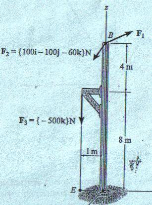

Using Cartesian vector analysis determine the moment of the three forces about the base of the column at A. F1 =400i +300j+120k
The [tex]x[/tex] represents "cross"..i don't know the latex for it
[tex]M_a = r x F[/tex] (summation)
I keep getting the wrong answer and I think it has something to do with the point E. What does this have to do with anything?
What I am doing is summing all the forces crossed with their distances.
[tex]r_B={12k}N[/tex]
[tex]r_{F3}={0i-j+8k}N[/tex]
So [tex]M_A = (r_B x F_1) + (r_B x F_2) + (r_{F3} x F_3)[/tex]

M_A = {12k x 400i} + {12k x 300j} + {0i-j+8k x 120k}M_A = 4800k x -300j + 1440i x 8kM_A = -1440k^2 + 384k^2M_A = -1056k^2
