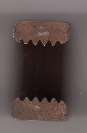

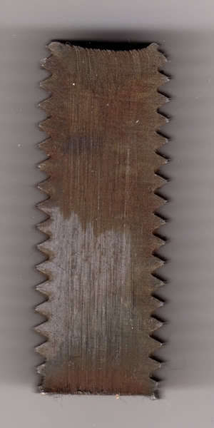

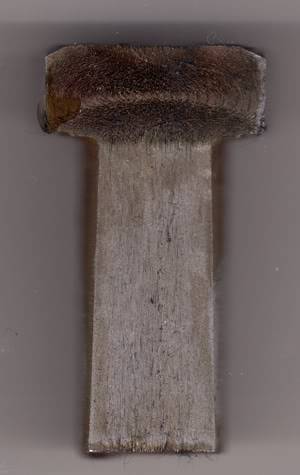

This is the eteched bolt and nut.. I would of thought that there would of been lines around the threads that showed the threads being formed. Interesting?
top half
bottom half
nut
This is bringing back some long lab hours had nearly "erased" :-p . My 1st impression especially from the 2nd and 3rd figs is that your surface preparation doesn't quite "cut it", meaning it's too rough and hides any microstructural detail of orientation (see what brewnog said about sanding and polishing). Also, I'd do the etching in stages not to overdo it (time-wise) and see whether something starts to appear, then etch more if not. Also2 whatever you're going so see is probably not going to appear macroscopically (too well at least), but rather you're going to have to take a pretty close look near the bottom of the threads (since the deformation probably isn't close to what you'd see in for example a forged piece of material).
Well it was originially smooth and clean, but it was amazing how as soon as they were pulled out of the acid, it began to currode so fast that you could infact watch it change colour, and so I dipped it into oil as soon as I relized that I probably should have, then took pictures after.

I'm just wondering.. I thought nuts were casted.. however, it appears from the etching that it was pressed or something from a solid piece of steel because the grains kind of curve, but it seems like the inside threads were machined or something because the grain keeps the same direction and doesn't become more dense around the threads.
