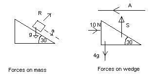

A wedge of mass 4kg and angle 30 degrees is at rest on a smooth horizontal table. a mass of 1kg is placed on the smooth inclined face of the wedge and a horizontal force of 10N is applied to towards the vertical face of the wedge. Show that the acceleration of the wedge is
(40 - root(3g) ) / 17 ~= 1.35m/s.
Also find the reaction force between the wedge and the mass
(from diagrams)
Equation of wedge horizontally
4A = 10 - Rsin30 (1)
Equation of mass horizontally
A + acos30 = Rsin30
A = Rsin30 - acos30 (2)
Equation of mass vertically
asin30 = g - Rcos30 (3)
Substitute (2) into (1)
4(Rsin30 - acos30) = 10 - Rsin30
5Rsin30 - 4acos30 = 10
5Rsin30 = 10 + 4acos30
5R* 1/2 = 4a * root(3)/2 + 10
5R/2 = 2 root(3)a + 10
5R = 4root(3)a + 20
R = ((4root(3)a) / 5) + 4
Now I have 'R' in terms of 'a', but I'm not sure where to go. My notes on this trail off...I seem to substitute R back into equation (1), along with equation (2) but that will just give me R in terms of a again.
it seems you missed a equation.
you can achieve a=2g-root(3)R from
then subtitute it to
5R = 4root(3)a + 20
it can give you R without a
besides, i really cann't understand then method you used in this problem and so as what the A stand for.i suggest you consider more ways.
5R = 4root(3)a + 20
where does the 'missing equation' come from?
I can't actually recall why A is there, though I'm sure i need it :/ could it be the force of the mass pushing the wedge back?
:-p
you missed equation (3)
just tell me what the A stand for in the picture in order to let me understand it in your way.
sorry for the delay in replying.
A represents the acceleration of the wedge.
really sorry for so many days' delay.
in my peasonal sense,non-inertial frame will greatly predigest the problem.just use the wedge as frame.
in addition,you missed a force on wedge in the maps you gave.
happy new day!
