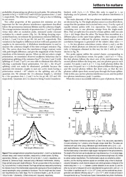

I'm basically just doing some quantum optics experiments for example this paper by Charles Santori:
http://www.nature.com/nature/journal/v419/n6907/abs/nature01086.html
(see attachment as well)
Which refers to photons emitted from a quantum dot. It is said that when there is no pure dephasing that the ratio of 2*(decay time)/(coherence time) = 1 and this means the photons are time-bandwidth or Fourier Transform limited. And apparently this means that your single photons are indistinguishable. After spending hours on google it seams that Transform limited photons are used in spectroscopy in other fields as well..
I just want to know physically and mathematically what a FT limited photon is.
