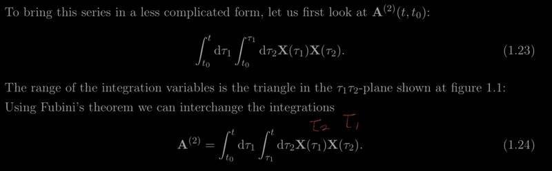

vanhees71 said:
Now we rename the integration variables on the right-hand side of the equation and in another step use the time-ordering operator:
$$\int_{t_0}^t \mathrm{d} t_2 \int_{t_0}^{t_2} \mathrm{d} t_1 \hat{H}_I(t_2) \hat{H}_I(t_1) = \int_{t_0}^t \mathrm{d} t_2 \int_{t_2}^{t} \mathrm{d} t_1 \hat{H}_I(t_1) \hat{H}_I(t_2)= \int_{t_0}^t \mathrm{d} t_2 \int_{t_2}^{t} \mathrm{d} t_1 \mathcal{T} \hat{H}_I(t_2) \hat{H}_I(t_1).$$
Hi Vanhees. Is this a typo in your book?, https://th.physik.uni-frankfurt.de/~hees/publ/lect.pdf
  • Love
Thanks a lot of pointing this out. In (1.24) the time arguments have to be exchanged. It's always time-ordered, i.e., the operators are time-ordered from right to left. In (1.24) ##\tau_2>\tau_1##, i.e.,
$$A^{(2)}=\int_{t_0}^t \mathrm{d} \tau_1 \int_{\tau_1}^t \mathrm{d} \tau_2 \mathbf{X}(\tau_2) \mathbf{X}(\tau_1).$$
I also corrected the typo in the corresponding figure ;-).
