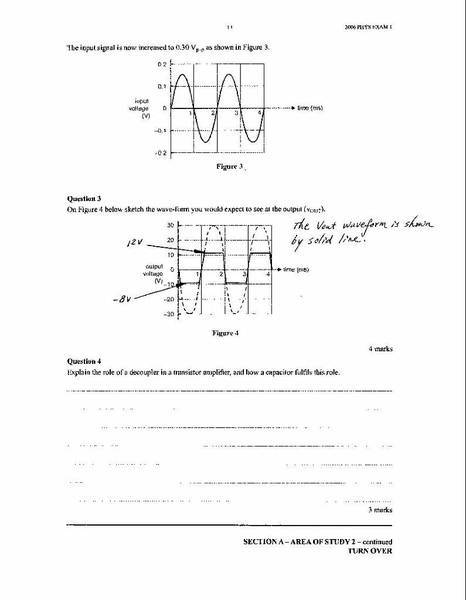

My year 12 exams are in 1 week exactly and I'm worried about a question (from last year's exam) that my teacher can't even answer. Each year they tend to repeat the difficult questions, and this was one of those.
I'll just give a summary of the question, and maybe you'll be able to answer my question without having to look at it.
- An AC input signal of 0.3V peak to peak is applied at the base.
- There is also a DC voltage of 4 V going through the base.
- The voltage gain is 200.
- The DC supply voltage is 20 V.
- They don't give a linear transfer characteristic.
To answer the question, you have to draw a graph of output voltage against time. In their answer, the graph is clipped at +8 and -12. I don't understand where they got those values from. What I thought I had to do was add the AC voltage to the DC across the base (ie. sinusoidal from 3.85 to 4.15, varying about 4V) and then normally you just read off the V in against V out graph.

I talked to my teacher about it, and the answer she was told was this:
-The clipping at the top is the same as the voltage drop across Rc (8V)
-Then you know what the bottom clipping is because the value from 0 to the top clipping + 0 to the bottom clipping is the supply voltage (20V) which makes the bottom clipping -12V.
Is this correct in any way. It's ok if I don't understand the science behind it, but is that the right way to go about doing the question?

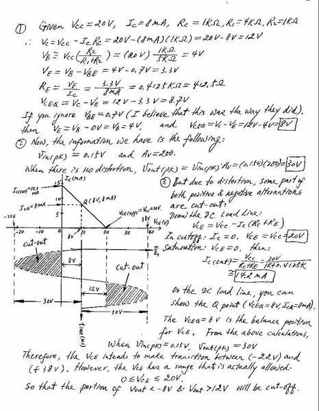

I don't like that approach at all.Here is an easier way to do it. You have to draw the DC loadline. You do know how to draw one right? On the line you'll of course plot Icq and Vceq. SO we have have Vin peak as 0.15V with a gain of 200. This means that the amplifier will be producing a 30V peak output wave form. But because of clipping, the positive and negative portions are distorted. To find the exact points of clipping, you'll that DC loadline I told you to draw.
Looking at the DC loadline, the range of [output] swing is basically from 0 <= Vce <= Vce(off). Vce(off) in this case is 20V. Like I said before, the output (Vce) will oscillate about its quiescent point (Vceq). This basically means that Vceq will be the horizontal axis when analyzing the graph.
Note: when I analyzed it, I got the answer you gave only when ignoring Vbe (0.7V). And I got -8V and +12V as the clipping points and not +8V and -12V.

Check out
http://www.vcaa.vic.edu.au/vce/studies/physics/assessreports/2006/physicsassessrpjune06.pdf
page 4 tells you the answer to this question. Not the same signs as your clipping this is so frustrating.

ranger said:
I usually don't do this, but you guys need it for a test on Monday, I'll post some work:
