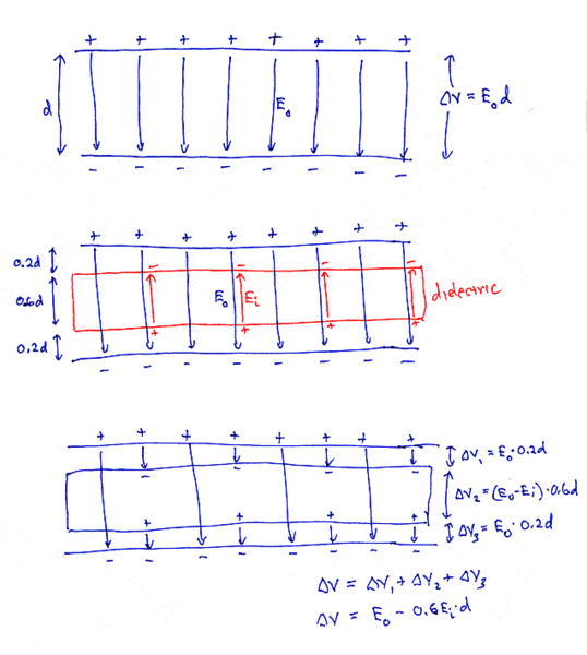

Hello Everyone!
I am a new member in this forum.:cool:
What we learn at school regarding dielectrics is: When you apply an electric field on a dielectric, the molecules of the dielectrics polarize and stretch (the electrons/anions shift towards the positive terminal, and the cations shift towards the negative terminal), which creates an opposing field, which reduces the net applied electric field.
This is what I think the above statement means : that if you have two metal plates separated by a dielectric medium, and apply an electric field across the two plates, thenthe field travels from the positive plate, enters the dielectric, does work in polarizing/stretching its molecules, gets reduced and reaches the opposite plate with this reduced value.
But I ask: why does the electric field only do a limited amount of work? Why doesn't the field stretch the dielectric's molecules to the fullest extent possible for it? Since electric field is also a kind of force, why isn't this whole force converted to work done in stretching the dielectric.
According to me, the molecules of the dielectric should consume the whole applied electric field and stretch accordingly and, thus, no electric field should ever reach the negative plate, as all the field is converted to work done in stretching. This is what happens in an insulator.
Then what makes the dielectric absorb a limited amount of field and let the rest of it pass through.
Please answer me this question in any way you know (quantum approach, QED or classical approach), but make it with minimum or no mathematics, because I want to understand the theoretical portion, and also because since I am still school student, I won't understand the complicated quantum maths much.

Never mind. I think I have found the answer to my question. And it is quite simple, the way I look at it.
Dielectrics, like insulators, absorb all the electric field. What differentiates them from insulators is their ability to stretch in a given external field.
Suppose we have a single positively charged metal plate of infinite length, exerting a field x in both directions:
hi, in principle an ideal insulator will never depolarize any electric field because by definition the charges are not allowed to move around their initial position. You can think of this ideal-ness as supplied by other sources of restoring force such as nuclear strong force of just simply an overwhelming strong electrostatic force.
On the other hand, an ideal conductor will completely depolarize the electric field because by definition the conductor can supply free charge (delocalized electron sea) to do it.
Hi MV,
You got it, though I wouldn't talk about dielectrics etc. "absorbing" electric fields. When we apply an electric field, we put that field in and that field is there -- that's what we mean. It doesn't get "absorbed" or anything like that. Rather, this field causes the dielectric material to polarize. The polarized molecules create their own electric field, which happens to be opposite to the applied field. So the total field you get is smaller than the applied one.
But you're absolutely right that what makes the difference is how much the charges in the material can "stretch." In a conductor, charges are basically completely free: they will move around to completely cancel out an imposed electric field. (This is why the E field is always zero inside a conductor!) In a dielectric, molecules can stretch a little, but they are still attached together. Think of them as being two little charges (one + and one -) attached by a spring or rubber band. This attachment force let's the molecules stretch to cancel out a little of the applied field, but stops them from moving enough to completely cancel it.

^^^ You're right in that when we impose a field on a dielectric, work is done on the dielectric itself. But we need to be careful about terminology here. When we talk about imposing a field, that means we set up charges in order to create the specified field (or in this case, what would be the specified field if no material were present.) Because of the energy going into the dielectric, the amount of work that needs to be done to set up this field changes... but the imposed field itself isn't 'absorbed' in any sense. In this situation, we have a fixed imposed field, which can require any amount of energy to set up. We don't have a fixed amount of energy which can be "used up."
Onto the central point, the mistake is that objects don't "absorb all the energy that is provided to them." I'm not sure where this came from; it's certainly not true. (It's not even meaningful -- what would it mean? Say we couple two systems together; which one will absorb all the energy? They can't both do so!)
If you want to think about the microphysics of what's going on, consider a simplistic model of a dielectric molecule. We can distort the atom in order to polarize it. But in doing so we're pulling the molecule out of its lowest-energy configuration, and hence there's a restoring force that resists us. At some point this force will become sufficiently strong to stop the molecule from polarizing further.
It might help to think of a toy system of two charges attached by a spring. If I place this system in an electric field, the degree to which it polarizes depends on the spring constant ( dx ~ E_eff*q/k). So in the limit that k is very large, we get no polarization; if k is small, the polarization will be nearly complete.

Don't confuse energy with force! They're different concepts. Let's draw out our toy model a bit more. If each end of the molecule has charge q, and the imposed field is E (ignoring other molecules for the moment), then the work done on the molecule (neglecting the electric attraction of the molecule itself) is
Work = 1/2 * k*dx^2 ~ E^2*q^2 / k
Note that this depends on k, which has nothing to do with the imposed field. Indeed, in the limit as k -> infinity, the energy in the molecule goes to zero. It's only in the limit that k->0 that the "absorbed" energy of the molecule will approach that of the local imposed E field.
While it's possible to view static fields as being composed of photons, it's not straightforward and often not helpful. For example, no static field configuration can possesses a definite number of photons. Indeed IIRC for electrostatic fields we have to include states with unbounded (ie infinite) numbers of photons present. In this case, where no quantum effects need to be introduced to understand the basic phenomenon, trying to understand static fields from a virtual photon standpoint is particularly unhelpful... Naively thinking of "absorbing" and "emitting" photons is going to lead your intuition in exactly the wrong direction. (For example, opposite charges attract, but it is not easy to see how this comes about through the emissions and absorption of virtual photons!)

Insulators ARE dielectrics. Think about it, dielectrics are media that posses no free charges. Insulators, too are defined as possessing no free charges (which is why they conduct electricity and heat so poorly compared to conductors).
Claude.
No, not if you go deeper. Dielectrics are insulators, but insulators are not dielectrics. Dielectrics are insulators which allow some of the applied field to pass through them. Insulators do not allow any field to pass through. So, you see - insulators are not dielectric. It is like dielectrics are special type of insulators.
Wherever did you hear such a thing? Can you provide a reference? The best interpretation of this statement I could make is that you think there are substances where the entire applied E field is reduced to 0 inside that substance. Such substances do exist, they are called conductors. Are you saying conductor = insulator :confused:.
Not to mention the implicit contradiction in the statement that "dielectrics are special types of insulators" despite the fact their definitions as you have presented it are mutually exclusive.

1. Agreed, though the word "opposes" is more correct than "cancels" because cancels carries with it the implication that there is nothing left.
2. Materials with a higher permittivity and thus a higher induced field are better intermediate layers for capacitors in terms of storing charge because the higher induced field results in a lower net field, which allows the capacitor to pack more charge on its plates.
3. Yes.
4. No, an ideal insulator will undergo zero polarisation because in a perfect insulator, the charges are completely immobile. This would result in zero dampening of the applied field. The situation as you describe it is physically impossible, since it implies we can cram an infinite amount of charge on the plates of a capacitor.
5. Loosely correct, except in reference to the insulator.
I think the main point to be made is number 4, a perfect insulator has zero charge mobility, in other words the charges in a perfect insulator are completely immobile, not, as you seem to think, infinitely mobile yet bound.
Claude.
Yeah, that is the main point that is troubling me. Actually, damgo first suggested me to compare the working of a dielectric with the working of a spring.
Now,
1. if spring's k is low, stretching is high and applied force decreases drastically. Similarly, if polarization is high, then external field falls sharply.
2. if spring's k is high, stretching is low and applied force decreases only by a small measure. Similarly, if polarization is low, then applied field decreases only slightly.
But if you consider a solid rod, it does not stretch at all, because it has almost infinite k. Thus, applied field does not decrease at all. Here I am stuck up. If you apply this analogy to dielectrics, then an insulator does not stretch at all too, which should mean that external field is not reduced, which means that almost all the field should reach the other end of the insulator. But this does not happen. Why? Am I wrong, or is the spring-analogy not applicable in this case? How would you exactly describe the absence of electric field without the absorption of any?
धन्यवाद (thank you)
regards
Mr V
Why do you insist that the electric field must be completely absent inside an insulator? Maybe you are confusing the fact that a perfect insulator generates a negligible field in response to the applied field, and not that the applied field itself becomes negligible.
Consider that a vacuum is a very good insulator, and that one would not expect any reduction of an applied E-field at all due to the absence of any dipoles.
Mr Virtual said:
धन्यवाद (thank you)
You're welcome :smile:.
Claude.
Actually I am in a hurry, I have to get ready for school. I will answer you when I come back.
देरी के लिये क्षमा करे !(Sorry for the delay)
Mr V
Just reached home.
Electric field is not completey absent inside an insulator. Applied electric field reduces only slightly due to negligible opposing field of insulator.
No, no, I do not have any such confusion. I agree with what you said 100%. But my question is, if the applied field is only negligibly opposed by the internal field, then where does this applied field go? Why doesn't it end, in its full strength, on the other side of the insulator. What consumes this field?
Mr V
Why do you think that there is no electric field on the other side of an insulator from the field's source?
Are you perhaps confusing electric field with electric current?
So, according to you, if we use an insulator in a capacitor (instead of a dielectric), then, since an insulator does not oppose applied field much, almost all the field should reach the opposite plate and induce opposite charge on it.
But as far as I know, insulators allow only a negligible part of applied electric field to pass through them. Am I wrong here?
Also, if insulators do not polarize and have very small opposing field, then they should have quite a small dielectric constant (which depends directly on the amount of polarization). Is it so? I mean if dielectric constant of a conductor is close to infinity, then is it close to 0 for an insulator?
No, no. Of course not. Current cannot pass through insulators/dielectrics in normal conditions (except in case of dielectric breakdown), whereas field can.
Please correct me where I am wrong.
Mr V
Yes!
That's the point, it does!
Claude.
So that means an insulator is not suitable for storing charges in a capacitor, as most of the field reaches the other plate without any decrease in its magnitude, resulting in negligible drop in potential difference. Right?
Mr V
