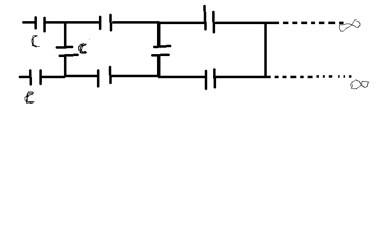

somebody help me solve this question please
find eq capacitance when each capacitoras capaccitance C
h
hi please anser this
this is not good see next post

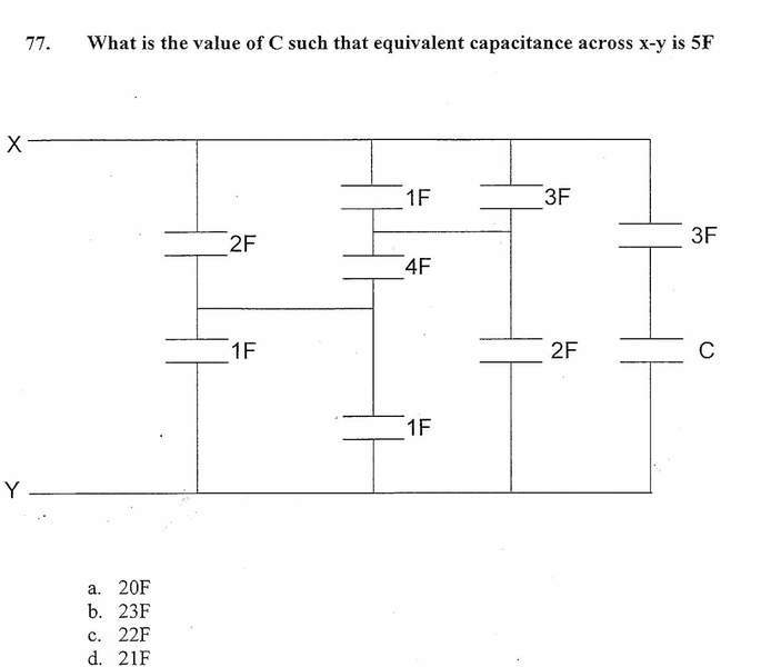

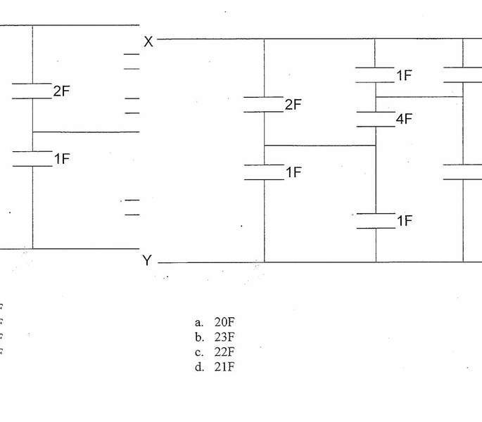

please answer this
regards
