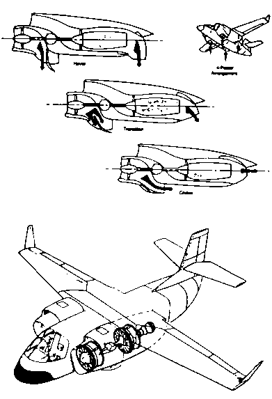

I had an idea once which I'd like to go into a little. It involves how a fan or propeller draws in air verses only providing thrust.
The idea is/was to cut down on aerodynamic drag and resistance a propeller imposes once the craft is up to speed. By having a remote fan/propeller air intake like a jet or even a NACA inlet; in-line tandem fans which are located down a serpentine duct would provide thrust.
The first fan/propeller would act to drawn air into the air intake plenum feed duct; the second fan would kick it up a notch. Much like a compressor.
The second fan might rotate in the same direction or be counter-rotating; it does not matter at this point. I would also use additional duct length to straighten the flow in lieu of stator vanes AFTER THE LAST FAN.
All this together is aerodynamic and quiet if not the last word in weight control or efficiency margins.
I'm not claiming this is a new idea or invention, do a search on "cold jet" or "cold thrust", pre-WWII Italy had an example or two, and of course there was Henri COANDA in 1910.
Example the Davis Wing:
http://members.cox.net/rebid/DavisWing.html
Note: The inlet may not always face the direction of motion in my example, it could be at a right angle. This might also be used in a hovercraft, not just an aircraft.
What do I need to know or reference to pull off such a configuration?
Sounds like a more complex way of driving a turbofan.
Not a turbofan; it's just a basic ducted fan. Nothing special there. The machine would probably be more efficient if that same engine power was directed through a propeller.

If you can't see why this won't work with fans rotating in the same direction (at the same speed) with no stator vanes, I think you need to learn some basic fluid mechanics of turbomachinery.
Contra-rotating two stage fans, both ducted and unducted, are nothing new of course.

Okay, let's say we have stator vanes in between the fans.
Now what?
As I understand the concept the first fan is of shallow pitch, the second fan greater pitch. To keep it simple I want to stay away from Contra-rotating fans.
In essence the first fan is feeding the second fan higher velocity air or is it higher pressure air? Why is this a good or bad thing? The first fan in the scenario I've outlined is also acting to draw air in which is part of the work its doing.
Assume I know nothing of the basic fluid mechanics of turbomachinery (which I don't), where do we go next?
EDIT: Found this......click to see figures
http://web.mit.edu/16.unified/www/SPRING/propulsion/UnifiedPropulsion9/UnifiedPropulsion9.htm
The stator removes swirl from the flow, but it is not a moving blade row and thus cannot add any net energy to the flow. Rather, the stator rather converts the kinetic energy associated with swirl to internal energy (raising the static pressure of the flow). Thus typical velocity and pressure profiles through a multistage axial compressor look like those shown in Figure 9.5.

This appears to be quite similar to the drive system for jet-boat. The material being moved is quite different in density, but the principle is the same.
In either case (water or air) the intake duct introduces frictional losses that decrease the efficiency of the system, regardless of the direction of flow.
A similar application (kort nozzles) is used on slow moving watercraft to gain thrust. These are ineffective above a threshold speed as they induce more and more drag on the vessel.

1) the body moves forward because of the momentum the engine imparts on the air (and vice versa) Momentum is mass times velocity, so high velocity is good. In turbofans, the annular flow through the fan is high velocity, high mass flow of air to achieve the bulk of the thrust. The flow through the core is there to power the jet engine which drives the fan. As the core flow goes through the compressor, it slows down as pressure goes up. Increased pressure is desired so the air has better combustion properties. After blowing up the air with fuel, it accelerates and drives the turbine, which drives the compressor and fan.
2) This is like saying the faster you go the more drag you feel.
3) Since the success of a new technology depends on whether or not it meets the needs of the customers, I think it would be good to get some numbers on the safety issue. Ex- how many people are injured every year due the engines? How can you quantify the improved safety? You need the baseline data. Also the noise issue is important, and any improvements in this area would be well received. They key is to show that your up front design requirements (related to safety and noise) are actually desired by the aerospace industry.
You are partly right.
You get the same momentum if you have a high mass and low velocity or low mass and high velocity but that does not tell the story.
The conversion of fuel (chemical energy) into kinetic energy determines the thermal or internal efficiency of engine, while the conversion of the KE to propulsive work determines the propulsive or external efficiency. This depends on the amount of KE wasted by the propelling mechanism, which in turn depends on the mass airflow multiplied by the velocity squared. A propeller moves a larger mass at lower velocity that a turbojet (especially the first generation), which uses a low mass at high velocity. From this we can see that the high-velocity, relatively low weight jet exhaust wastes considerably more energy than a propeller with its low-velocity, high mass airflow.
The turbofan is more fuel efficiency, because, with the same rated thrust, it wastes less KE and hence has more propulsive efficiency. Average fan/core exhaust velocity (V2) is closer to aircraft speed (V1). Amount of KE left in atmosphere is less. Here is an example:
Turbine expels 10 mass units of air at 1000 ft/sec KE = .5*10*1000*1000 = 5 million ft lbs of waste energy
If you double the velocity you get .5 * 10 * 2000*2000 = 20 million ft lbs of waste energy.
If you design the engine to double the mass and have original velocity then KE = .5 * 20 * 1000 * 1000 = .10 million ft-lbs of waste energy. This is a factor of two compared to four for same momentum.
The max thrust for the least fuel flow can be obtained by giving the smallest acceleration to the largest possible mass airflow. Fanjets are better than turbojets and the propeller is better, but it is limited to lower speeds due to prop inefficiency.
