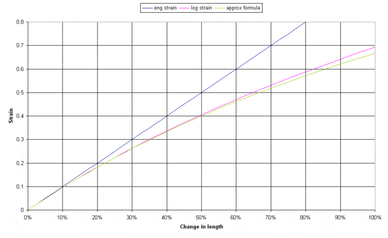

There are two standard measures for strain.
Linear (engineering) strain is (L-Lo)/Lo
Logarithmic strain (sometimes used for large strains) is ln(1 + L/Lo)
Your second formula is a pretty good approximation to log strain - see picture.
Why anybody would want to use the approximation, I don't know - unless it's meant for people who are not too happy about maths, and/or might get confused between common logs (to base 10) and natural logs.

I plotted the graphs in a spreadsheet, using the formulas given in the thread.
The idea of logarithmic strain is based on adding up strain increments based on the current length, not the original length. E.g. imagine a 1in long bar of flexible material that is stretched to 2in long. Logarithmic strain says that an additional stretch from 2.00 to 2.02 is "the same increment of strain" as the initial stretch from 1.00 to 1.01. Engineering strain says a stretch of 2.00 to 2.02 is "twice as much strain " as a stretch from 1.00 to 1.01. If you take this to the limit and add up very small increments, you get the ln(1 + l/l0) strain formula. (See any textbook on strain measures for large strains for a reference)
Measuring the strain based on the average length not the original length, makes sense as a physical approximation to log strain. It's similar to evaluation an integral numerically, using just one increment of the trapezium rule. (You could derive it mathematically using a standard curve-fitting technique like Pade approximations, but that doesn't explain why it makes sense).
I don't know anything about the PFC3D code, so I've no idea why the code uses the approximation.
