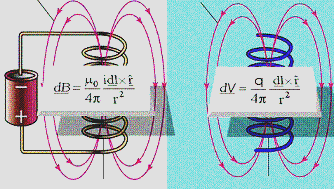

I need only one photon from a coil and battery set up.
Anyone know how I can get just one photon?
e.g. 1) slowly increasing ramp voltage that spits out single photons slowly?
2) Send a tiny voltage in by pushing a switch?
3) Have many windings or just a few?
Any clues please, would be most grateful. How does E = hf apply to a coil exactly?

You cannot create "single photons" this way. All single-photon sources are created via energy transition, not 'classical' setup like this.Zz.
I need just one photon
But a coil would release photons, so cannot I get just one?
Say, I make a 'step' by applying a step voltage to a coil? or
filter the stream somehow (but how?)
I must have some basic misunderstanding of school physics if
only atom energy transitions allow me to get a single photon.
There are no physics in which to apply to the technique that you are describing that can get you one photon at a time.
Zz.
It is indeed impossible to generatore single photons this way. There are many reasons why; but one "obvious" problem should be the energies involved. Try calculating the energy of a photon (in a setup like this the relevant frequency is probably a few hundred kHz at most) then compare that number to the energy in the coil.
Even if you could generate a number state (i.e. a state with a definite number of photons, e.g. 1) you would end up with an enormous amount of photons, not one.
As an excersise you can also try calculating the number of photons generated in the same frequency range due to the thermal radiation (because the coil is at room temperature and not at zero kelvin).
I should perhaps point out that it IS possible to generate single photons using electrical circuits, i.e. high-quality microwave resonators operated at very low temperatures, but you need some pretty sophisticated equipment.
Yes, thanks f95toli, I calculated that even for a very low inductance coil the current needed to produce one photon is thousandths of a microamp. My yellow plastic voltmeter does not go that low and, as you righlty say, thermal photons would be everywhere messing my experiments up - the little wrigglers!
