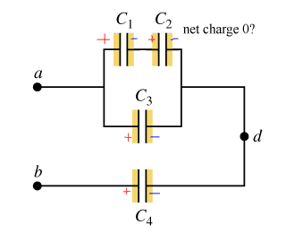

In the figure View Figure , each capacitor has 4.00 micro F and V = 34.0 V.
Calculate the charge on each capacitor.
Q= CV
I know that to get the charge of a capacitor we need to use Q = CV, also that capacitor in parallel add, and capacitor in series add reciprocals.
This is what I thought it would be with charge on each of 0.
I don't know what you mean by having 0 charge, but try using a table:
[tex] \begin{array}{|c|c|c|c|}<br /> \hline<br /> & C & V & Q \\<br /> \hline<br /> 1 &\qquad &\qquad &\qquad \\<br /> 2&&&\\<br /> 3&&&\\<br /> 4&&&\\<br /> eq&&&\\<br /> 1,2&&&\\<br /> 1,2,3&&&\\<br /> \hline<br /> \end{array}[/tex]
It seems that the best way to work out this problem would be to find the equivalent capacitance and then the total charge. Once you have this, work your way back to the original circuit step by step and in the process find the charge. This is analogous to a series-parallel resistor network.
The thing is that charge on the plates of the capacitor are equal but opposite. That gives a total net charge of zero. Unfortunately the answer to your problem is not zero. When they ask to find charge, they don't mean net charge. Instead they want the charge on either plate, -Q or +Q. Quantity is the same, but their signs are opposite.

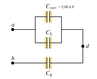

So, I got the C equiv for the parallel as shown below:

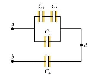

and I got the series as shown below:
but how do I simplify this even more, because I notice there is a d point there, and don't know what to do with it.
(I edited the last two. o:) )
Just ignore it. All it is is a reference to a specific spot on the wire. It doesn't represent any physical object.

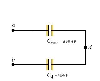

The first image was given by the problem..the rest I just edited in photoshop. so I treat the circuit as a series now? If so, what do I do with the equivalent capacitance?
With the equivalent capacitance you can find the total charge. Then work your way back to the original circuit one step at a time, while finding the charge and voltage in each step. Its like working backwards from the equivalent capacitance to the original circuit. Remember the same rules that apply for series and parallel networks (in terms of voltage and current or charge in this case) will work here.
