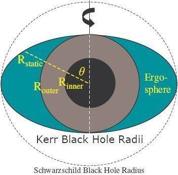

I was looking for surface gravity for a Kerr black hole on the web and happened upon a section on wiki which made reference to something called the Killing horizon (named after Wilhelm Killing) that had the following equation-

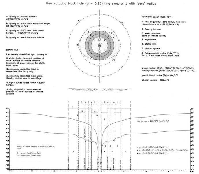

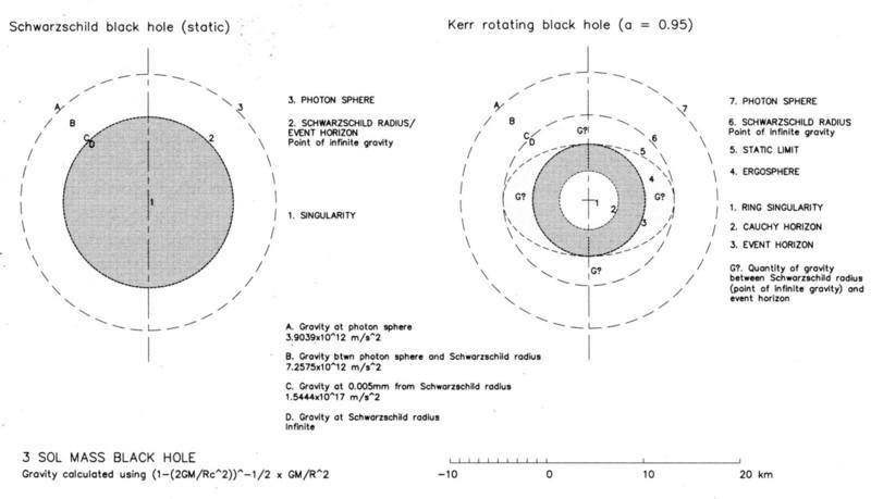

Attached is an image I put together comparing a 3 sol mass static black hole and a 3 sol mass rotating black hole (a = 0.95). I've used the modified Newtonian equation to calculate gravity for both black holes which results in gravity reaching infinite at the Schwarzschild radius for both types (the Schwarzschild radius is only apparent on the rotating black hole but the point of infinite gravity is the same for both models). I'd appreciate any feedback regarding the properties of gravity on the rotating black hole between the Schwarzschild radius and the outer event horizon (areas marked with G?).
Equations for rotating black hole-
Event horizon-
[tex]R+=(GM/c^{2}) (1+\sqrt{(1-a^{2})})[/tex]
Cauchy horizon-
[tex]R+=(GM/c^{2}) (1-\sqrt{(1-a^{2})})[/tex]
Static limit-
[tex]Re=(GM/c^{2}) (1+\sqrt{(1-a^{2}\,sin^{2}\theta)})\,\,\,\,\,\,\,\,\theta=latitude[/tex]
(equatorial edge equal to Schwarzschild radius, polar edge equal to event horizon)
Photon sphere-
[tex]Rps=3GM/c^{2}[/tex]
cheers
Steve

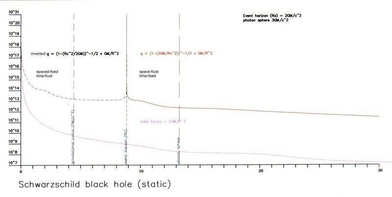

I was looking at the GR (Schwarzschild) coordinate acceleration equation while considering how gravity might be calculated (or estimated to some degree) beyond the event horizon. Keeping in mind that space and time are suppose to flip (or invert) at the event horizon, I looked at the option of inverting the 2GM/rc^2 part of the equation in order to maintain the flow of gravity and this produced results shown plotted in the attached document. While this isn't strictly speaking gravity as we know it, it does seem to collaborate with the curve outside the event horizon and the tidal forces.
equation for gravitational acceleration-
[tex]g=\frac{GM}{r^{2}}\frac{1}{\sqrt{1-2GM/rc^{2}}}[/tex]
Based on the principle that the original equation diverges (or inverts) at the event horizon, for gravity beyond the event horizon the following might apply-
[tex]\frac{2GM}{rc^{2}}[/tex] inverts to become [tex]\frac{1}{2GM/rc^{2}}[/tex] or [tex]\frac{rc^{2}}{2GM}[/tex]
This provides the following equation-
[tex]g=\frac{GM}{r^{2}}\frac{1}{\sqrt{1-rc^{2}/2GM}}[/tex]
Using the revised equation beyond the event horizon, gravity appears to pull back from infinity, picks up more or less on the same curve it had previously been following, then increases to infinity again as it approaches the singularity.
The equation may be more of a geometric curiosity but it does appear to provide worthwhile information.
regards
Steve

Attached is a graph for a 3 sol mass rotating black hole (a = 0.95) put together using the equations below-
Gravitational acceleration up to the event horizon for a rotating black hole (where a represents angular momentum, 0-1)-
