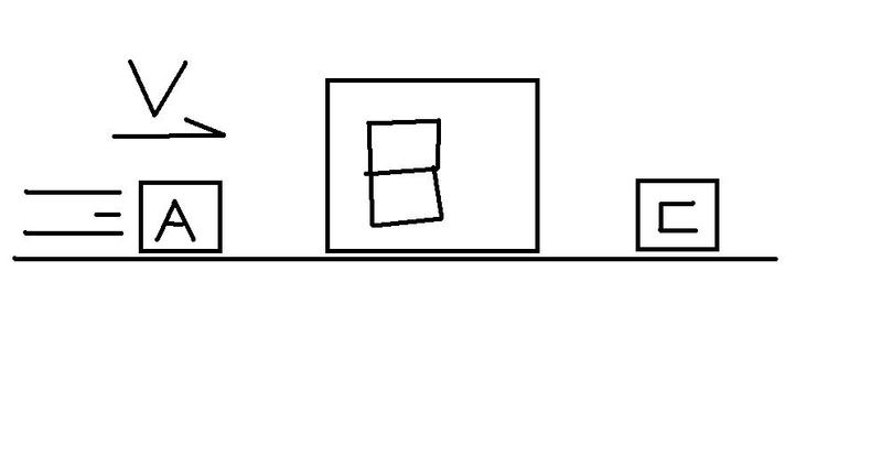

bloks b and c have m asses 2m and m respecti vely, and are at rest on a firctionless surface
black a also of mass m.. is heading at speed v toward block b as show... determine te final velocity of each block after alll subsequent collisions are over, assum all collision are elastic
v_1f = (m_1-m_2/(m_1+m_2)) * v_1i + (2m_2/(m_1+m_2)) * v_2i
and
v_2f = (2m_1/(m_1+m_2)) * v_1i + (m_2-m_1/(m_1+m_2)) * v_2i
i compared block A when it hits block B and then compared block C when block B hits it..
i got...
(m-2m / 2m+ m) * v
block a) - 1/3 v
found block b's v_i before it hits block c to be 2/3 v
(2m - m / 3m) *2/3v
block b) 2/9 v
(2*2m / 3m) *2/3v
block c) 8/9v
i feel confident these answers are right but just trying to see what others think

Before a and b collide their total momentum is m_a * v
After the collision of a and b if v_a = -1/3 and v_b = 1/3
m_a*v_a + m_b*v_b = 1/3 m_a * v so momentum wasn't conserved
mv + mv = mv + mv
ai -- bi -- af --bf
1 + 0 = 1/3 + 2/3
1 = 1 = momentum conservation...
negative for direction
anyone verify my answer?

you had -1/3v for the speed of a. -1/3 + 2/3 isn't equal to 1.
If you substitute the right values in the formula for v2_f that you gave, you should get
the right value for the speed of b after the first collision.
v_2f = (2*m / 3m) * v + 0
v_2f = 2/3v
i think my answers now are correct, and the negitive on the 1/3 is for direction, doesn't mean that momentum is not being conserved
True.
