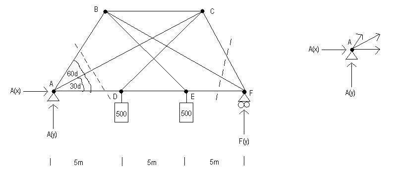

I have a mechanics test coming up and a the lecturer gave a very strong hint that a question like this with a scissor truss will be on the exam so how would you go about solving a question like this (finding force in all members).
I worked out the reaction forces as:
[tex]\sum[/tex]F(y) = 0 = A(y) + F(y) - 500 - 500 ; 1000 = A(y) + F(y) [eq1] .
[tex]\sum[/tex]F(x) = 0 = A(x)
[tex]\sum[/tex]M(A) = 0 = 15[F(y)] - (5x500) - (10x500) ; 15[F(y)] = 7500 ; F(y) = 500
Subbing F(y) = 500 into eq1 gives ; A(y) + 500 = 1000 ; A(y) = 500
So A(y) = F(y) = 500 and A(x) = 0 , with all forces being in kilo Newtons.
I know that it has to be done using the method of slices because there's no joint with only two unknowns.
Now my question is where do I take the slice? Because the only two places I can think of where there are only three unknown forces are long the dotted lines in the picture but that gives the problems of not being able to do a sum of moments equation. The reason for this is that all three unknowns would be concurrent from the same joint so no moment equation can be done around that point (please refer to the FBD I have so eloquently drawn).

I haven't worked this out, but you can sum moments for a section outside of the section. In your example, for your section near joint A, did you try summing the moments about D?

No I wasn't aware that you could do that. Would that sort-of be equivalent to using the section on the other side of the cut and then summing the moments about D? As in cutting along that same line however instead using the section that contains A (i.e. the left side of the cut) and using the section that contains D (i.e. the other side of the cut)?

that wouldn't be any different because you would still have the same forces exposed.
Is the length of AB the same as the length of AD? If so, after summing moments about point D to find force A(y) you could then determine the height of point B from point A and then sum moments about B to determine a(x).
I was able to find the forces in the members by setting up a series of simultaneous equations for four of the joints. Is there a quicker way to do it though?
yeah i think I've got it now, I just worked it out using the other section. I just used a series of simultaneous equations and plugged them into the graphics calculator and that's how we were taught. I guess a quicker way would be to plug them into a truss modeler or something anyway thanks for the help guys

Hrm actually sorry I got the length for AB quite simply... Since BAF is 60d and BFA is 30, ABF must be 90d. So then 15 sin 30 = 7.5 = AB.. But the rest of my questions stand :D

the solution is simple - first off, analysis by method of joints is much faster to solve for all member forces (axial forces) and not method of sections which focuses on specific members.
If you look at BE (or CD) you can see you can solve for this member by using the force at B (summing vertical forces = 0) by doing that, you can use one of the following methods:
(1) Use many simultaneous equations and solve through matrix calculation
resolving member forces at each remaining join into 2 simultaneous equations (F(h) = 0 F(v) = 0).
proceed to complete for all joins and members until you reach a point where you see (which should take only 2 or 3 more joins) that number of equations = number of unknowns
(2) Use the method of sections accordingly.
DC, DE, AC and AB where DE is known, continue to solve.
Hope this helps
Do the same for member CD (or BE)
