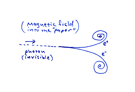

The positron was discovered in 1933 by observing tracks in a cloud chamber that behaved like electron tracks but curved in the opposite direction in a magnetic field.
Similarly, in bubble chambers, antiparticle tracks look just like particle tracks except for having opposite curvature. When I was a grad student, I saw many examples of electron-positron pairs produced by photons. As the electrons and positrons lost energy and momentum via multiple scattering in the chamber fluid, their tracks curled up in a distinctive pattern.
