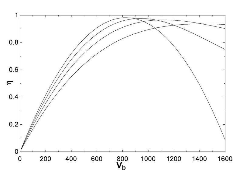

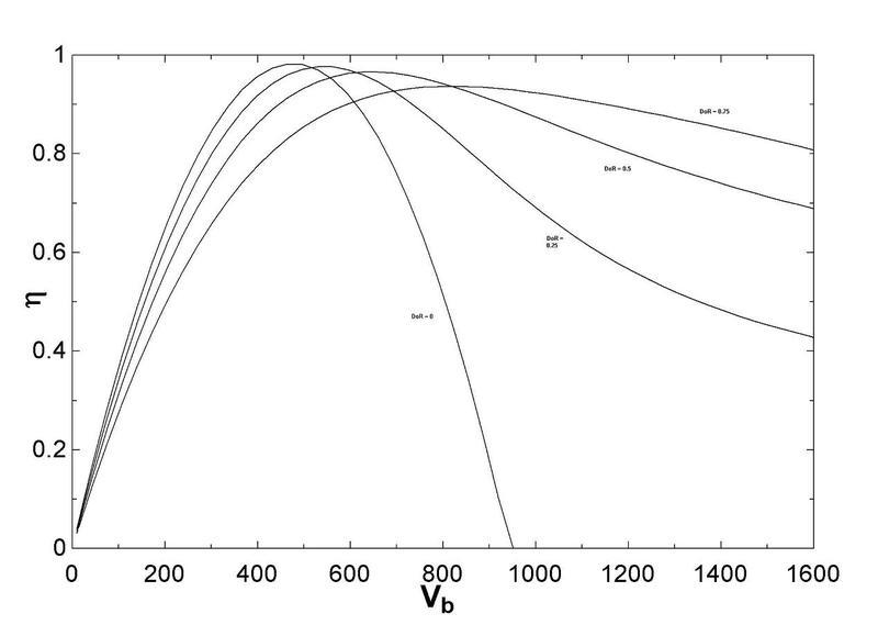

I am attaching two plots, showing the effect of DoR on efficiency. First plot is for a single stage turbine, while other one is for a 3 stage turbine.DoR is increasing as we go towards right. Leftmost plot is for DoR = 0, ie. impulse turbine
In multistage turbine, i have assumed that all three stages have equal enthalpy drop and DoR in all stages is constant. I have neglected the effects of losses. Enthalpy drops from 3574 kJ/kg to 2238 kJ/kg.
I am not very sure about this assumption, that the blades are short enough, so that blade velocity doesn't change much radially, & hence I didn't vary the blade inlet angle.
I am sure, parameters will change a bit, if we get a model closer to real world, but I dont think the trend will change anyways
Increasing DoR decreases maximum efficiency a little and increase the blade velocity at which maximum efficiency is attained. But Increasing DoR has a very interesting effect, it maintains high efficiency over a wide range of blade velocity, unlike an impulse turbine, which shows an upside down parabolic relation(also shown in the plot).
