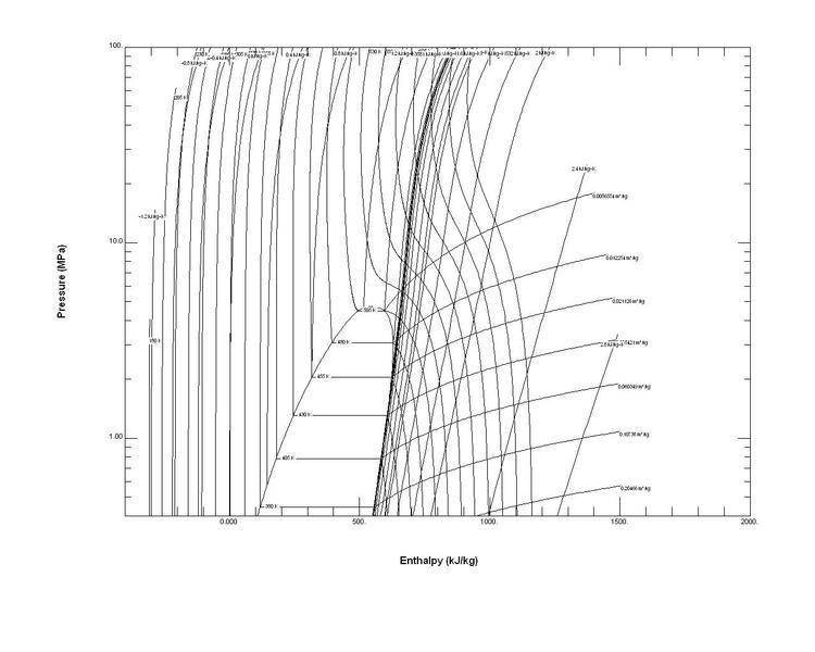

Quote Quote by stewartcs View Post
My version of REFPROP (from NIST) has acetone properties if you are interested.
CS
I checked NIST's online database, but they don't have Acetone properties there.
Are you able to generate a h-P chart (Enthalpy on the x-axis, Pressure on the log-scale y-axis) with Temperature, saturated liquid/vapor, specific volume, and entropy contour lines on the chart? Using such a chart would enable the calculation of basic effciencies and flow rates for the system being discussed.
Similar to the attached Propane properties chart I have attached.
File Type: pdf Thermodynamic Properties of Propane.pdf (172.4 KB, 5 views)
stewartcs
stewartcs is offline
#7
Jul29-08, 12:49 PM
Sci Advisor
stewartcs's Avatar
P: 2,283
Quote Quote by Mech_Engineer View Post
Yes. The plot export is hard to read though.
CS
EDIT: Just noticed it won't let me include anything but the Enthalpy and Pressure. I'll play around and see if I can get more on it somehow.

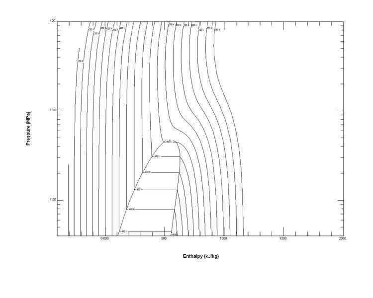

stewartcs
#8
Jul29-08, 01:02 PM
Sci Advisor
stewartcs's Avatar
P: 2,283
OK, I think this should have enough information on it.
Still hard to read though.
CS
