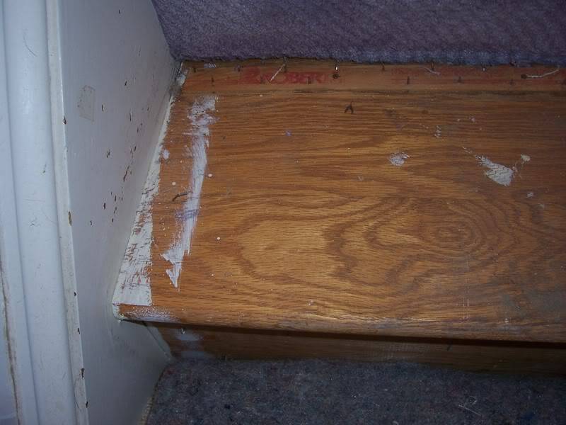

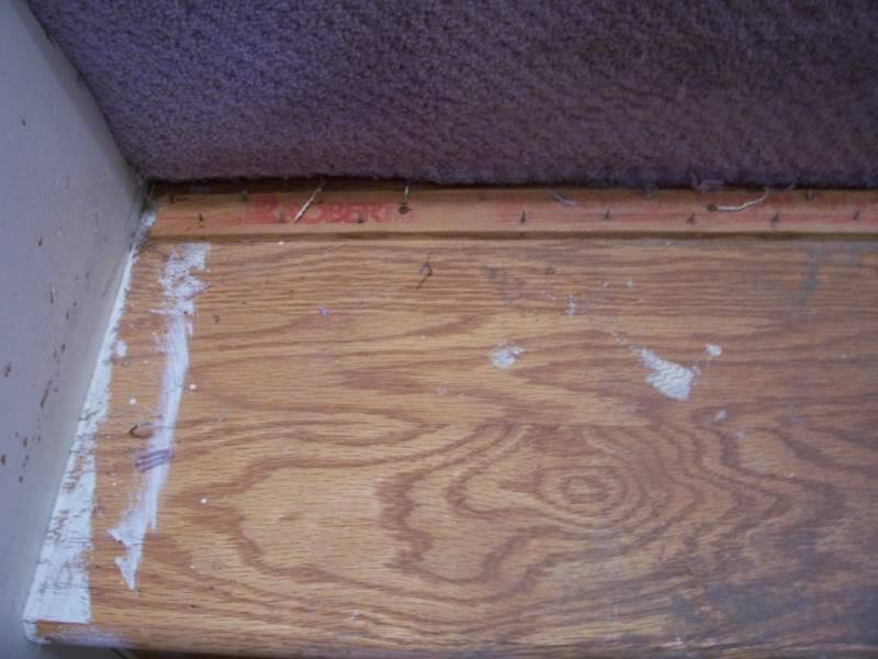

Someone painted on my Hardwood floors :( Any ideas?
So the folks who owned the house before my folks bought it clearly half-a$$ed a lot of things before we moved in. They put wall-to-wall carpeting in everywhere (over perfectly good hardwood floors:confused: )
Now it is clear that they knew they would be putting in carpeting, so instead of putting down masking tape or drop cloths, they simply just made a mess!
I peeled back the carpeting on one of the stairs to see what the floor looks like before I rip the whole thing up. The hardwood looks decent (mostly just dirty) BUT there is quite a bit of paint where they did the cutting in of the stairs.
Here are a couple of pics. Does anyone know a good way to remove the paint (I am pretty sure it is latex paint) without damaging the hardwood itself? Any good chemicals out there?
Or should I just leave the carpet (yuck!)?
Thanks!
Try rubbing alcohol. Leave on for a few minutes and then wipte off.
It might just come up with gentle use of a putty knife to scrape it, or fine steel wool. Though, from the look of the rest of the wood, you may need to refinish it anyway (this is common maintenance for hardwood floors, and sometimes a reason people who didn't want to bother with it put carpet on the wood). If you have to refinish it, that paint will just come up when you sand the floors to prep for the new finish.

As Greg suggested rubbing alcohol does work. If the paint is really thick in some places pour some alcohol on the area and cover it with a sheet of plastic so it won't evaporate to quickly.
CAUTION alcohol is flammable. Just do a small area at a time.

It looks like the wood was already urethaned which is good.
If it's brittle paint - well dried - you might be able to pop it up with a scraper or flat blade screwdriver at an angle. But don't press so hard that you scar the wood. If there is not a good bond with the urethane it might come up easily and dry.
It it is more stubbornly adhered, I'd then try a latex paint remover on a cloth or paper towel that I would moisten and then place on top and maybe on top of that a shopping bag or plastic sheet to limit evaporation for 30 minutes or so. That might soften it enough that you can scrape it up with a flat blade screw driver used like a scraper or even a small putty knife. Again try to avoid scarring the wood.
If you have a whole flight of stairs like that with sloppy painting on both sides it will be a bit of work and maybe more than you want to do.
In which case go to the last option which involves sanding it off all the way across - power sanding - and refinishing the stairs in a couple of coats of fresh urethane. (Given that the urethane already looks worn away in the middle this may be the way to go if you really want the stairs rejuvenated. The grayish oxidation of the wood in the middle is likely why it was carpeted in the first place.)
Good luck.

Is that carpet really...purple? !
NICE floors under it, though. Post before and after pictures - I bet it'll be beautiful.
