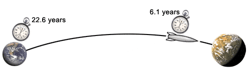

Something that will come in handy for exploring Gliese 581. At a comfortable 1G, the trip takes a mere 6.1 years ship's time while the Earth time is a tolerable 22.6 years. I made note of this in my http://www.davesbrain.ca/science/gliese/gliese_primer.html" .
