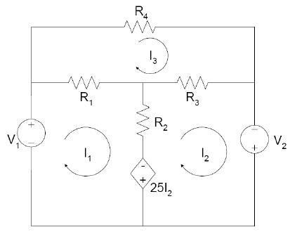

(See attachment for diagram)
Known Values:
R1 = 5
R2 = 15
R3 = 25
R4 = 5
V1 = 40
V2 = 20
I1 = 71/7
I2 = 25/7
I3 = 4
1) Find the power dissipated in each resistor
2) Find the power associated with each voltage source including the independent
source and specify whether it is delivered or dissipated.
3) Verify that the total delivered power equal the total dissipated power
P=RI2
P=VI
Power Dissipated:
(In the resistors)
P=RI2
R1*(I1- I3)2= 5(71/7-4)2 = 188.7
R2*(I1- I2)2=15(71/7-25/7)2 = 647.8
R3*(I3- I2)2=25(4-25/7)2 = 4.59
R4*(I3)2=5(4)2= 80
(By the voltage source in the middle of the branch)
P=VI
(25I2)(I2)=(25*25/7)(25/7)=318.8
Total Power Dissipated:1239.9
Power Supplied:
V1= 40(I1) = 405.7
V2= 20(I2) = 71.4
25I2* I1=905.6
Total Power Supplied: 1382.7
What am I doing wrong here in calculating the power supplied/absorbed?

HINT: What's the current through R2 / the dependent power supply?
You haven't solved the network correctly. The currents are:
I1 = 193/7
I2 = 79/7
I3 = 12
You probably made an error in setting up the equations to solve the network, but since you didn't show them, I can't tell you exactly where your error is.
