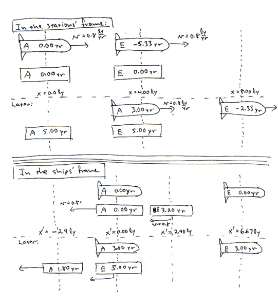

it's still not quite clear to me exactly what you're asking. So I've made a diagram and you can decide whether it answers your question. It shows the two ships and the two stations both in the reference frame in which the stations A and E are stationary (top), and in the reference frame in which the ships A and E are stationary (bottom). In each case, I show the situation at two different times: when ship A passes station A, and when ship A passes station E.
The rectangles are the stations. The things that look like rockets are the ships. The numbers are the readings on clocks carried on each station or ship, in years.
Distances are in light-years. The speed of light is c = 1 light-year / year. (This simplifies calculations a bit.)
Unlike JesseM, I assumed the distance between the ships equals the distance between the stations, in the stations' reference frame.
I've omitted the details of the calculations. If you have questions about the calculations, ask!
In both reference frames, ship A passes station A when the clock on ship A reads 0.00 yr and the clock on station A reads 0.00 yr; and ship A passes station E when the clock on ship A reads 3.00 yr and the clock on station E reads 5.00 yr.
In the stations' reference frame, as ship A travels from station A to station E, 5.00 yr elapse on both the station A and station E clocks; and 3.00 yr elapse on both the ship A and ship E clocks. That is, the ship clocks run slower than the station clocks, in the stations' rest frame.
In the ships' reference frame, as ship A travels from station A to station E (actually better described as station E traveling from its initial location to ship A), 3.00 yr elapse on both the ship A and ship E clocks; and 1.8 yr elapse on both the station A and station E clocls. That is, the station clocks run slower than the ship clocks, in the ships' rest frame.

Hi I am not talking about the numbers you derived. I am unclear regarding the basis of your choice of inertial frame to apply them from.
(1) Are not Earth'ship and Earth station both equally valid inertial frames?
(2) From the perspective of Earth ship ,,earth station is moving towards the ships at rest inertial frame at their relative v ?
And vice versa?
(3) From the perspective of either frame, a world line diagram would be a vertical vector for their own frame with a straight vector for the other frame at some angle to the left?
That these diagrams would be identical?
(4) That all the above would apply equally to alpha ship and alpha station regarding each other?
(5) That from either frame the expectation would be that the other frames clocks were dilated by Lorentz factor?
So my question is: What frame of reference are you using to determine that one frames clocks would be more dilated?? And therefore there would be a cumulative difference at the end of the elapsed time.
I am clearly missing something here. With the twins question it appeared that that preferential determination was made on the basis of acceleration and the fact that it implied an invalid inertial frame. But that is not a factor here so I am confused. Thanks
On what basis did you determine [from what frame] that it would be the ships clock that was actually dilated and thus showed a shorter elapsed time?
If it is the stations frame then what determined that it was those clocks that determined the cumulative results of dilation accurately?
From what frame or rational basis are you determining that between two equivalent valid inertial frames that there would be any cumulative difference in elapsed time between the frames?
In the ships' reference frame, as ship A travels from station A to station E (actually better described as station E traveling from its initial location to ship A), 3.00 yr elapse on both the ship A and ship E clocks; and 1.8 yr elapse on both the station A and station E clocks. That is, the station clocks run slower than the ship clocks, in the ships' rest frame.
In this case, the stations view of reality was accurate and the ship when it arrived conformed with the expected elapsed time but from the perspective of the ship the expected elapsed time for the station (1.8 yrs.) was widely divorced from the reality of (5 yrs).
What is the explanation for this asymmetry of perception??
