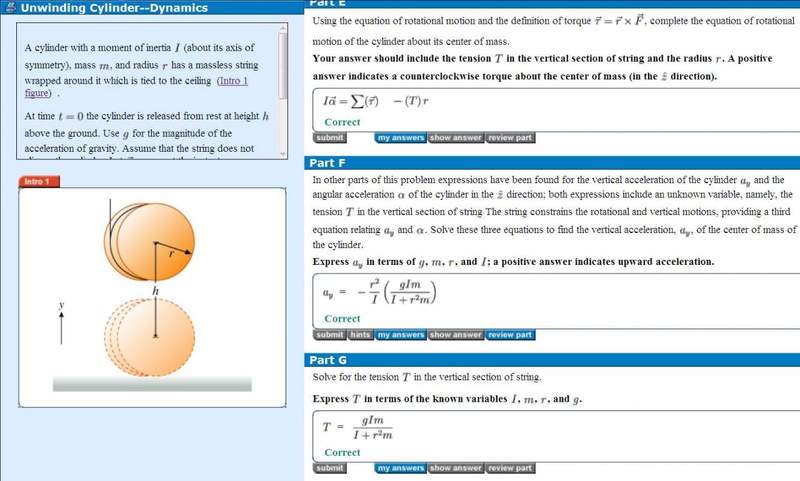

A cylinder with a moment of inertia I (about its axis of symmetry), mass m, and radius r has a massless string wrapped around it which is tied to the ceiling (Intro 1 figure) .
At time t=0 the cylinder is released from rest at height h above the ground. Use g for the magnitude of the acceleration of gravity. Assume that the string does not slip on the cylinder. Let v_vec represent the instantaneous velocity of the center of mass of the cylinder, and let omega_vec represent the instantaneous angular velocity of the cylinder about its center of mass. Note that there are no horizontal forces present, so for this problem
v_vec = -v(y-hat) and omega_vec = - omega(z-hat)
Torque = I(angular_acceleration)
F= m(linear_acceleration)

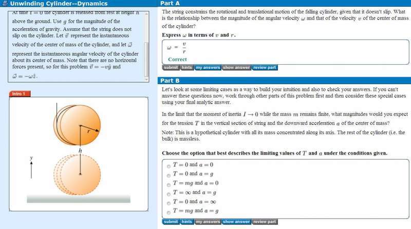

I'm having trouble with part B
T is the tension of the spring
if I goes to zero, the object will be turning faster in the -z direction.
The tension of the spring does less work on its rotation and more work on its linear momentum.
and so
If the T went to 0, then linear a should be g right?
because the tension does no work on either the angular and linear momentum and so the cylinder will just fall right?
the answer is the second choice
right?
if T went to infinity, then there would not be acceleration in the in the -y direction.
so if T went to infinity, a should be zero right?
if T equaled mg then linear acceleration would also be zero because the forces of the weight and T cancel out
right?

Um ... What is the problem asking you to solve? As far as I can see, it is just a bunch of information, but no question.
im having trouble with part B
i think when t=0, a = 0 because
if I goes to zero, t no longer does work on rotation but does work on linear acceleration
but if the tension goes to 0 then the object will continue to spin but simply fall in the -y direction due to gravity
right?

I don't quite understand your reasoning (and you seem to have contradicted yourself).
Why not apply Newton's law to translation and rotation and come up with some equations. Much easier to understand things when you put Newton to work.
ur right
i contradicted myself
anyway
my logic tells me
if t = 0, there is no tension and the object should just fall
and so -y direction its a=g (linear)
but the equations tells me otherwise
that when t = 0
a = 0
(as seen in picture)
that does not make sense to me though
why wouldn't the cylinder fall? gravity is still acting upon it
and since T=0 and I = 0
it can't be spinning right?
soupastupid said:
my logic tells me
OK. (But you have to show that T = 0.)
that when t = 0
a = 0
The equations don't say that. (Please simplify your equation for acceleration. That could be throwing you off.)

for vertical a in the -y direction
a_y = ( -gmr^2 ) / (I + mr^2)
i don't see T in the equation
so but it has to affect a_y
but i do see I
and if i make that equal to 0
i get
a_y = -g
WOWOW
thats amazing
thanks!
is that right?
now that I am looking at the problem more
if T = mg
shouldnt a_y equal to 0?
soupastupid said:
is that right?
Yep.
if T = mg
Sure, but T ≠ mg.

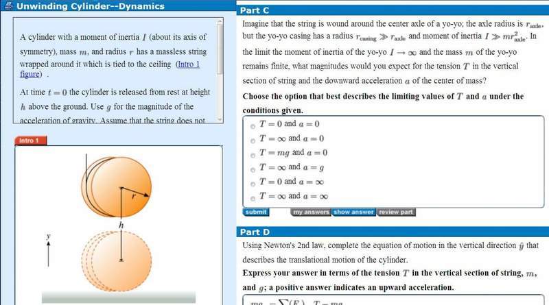

im having trouble with part c
it says its a yoyo
and the string is wrapped around the axis
and the radius casing >>>> radius of axis
but i didnt that would matter because the string is wrapped around the axis
but then the problem says
I >>>> m(r_axis)^2
and then i go ?
this is what i am thinking
using the equations
for then
T = (gIm) / (I + m(raxis)^2)
and so since I = infinity
T = mg
and when i plug that into a_y equation
a_y = -(T(r_axis)^2)/I <--am i using the right r?
and I = infinity
i get
a = 0
is that right??
using the equations
for then
T = mg
and I = infinity
i get
a = 0
is that right??
Good.
