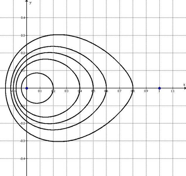

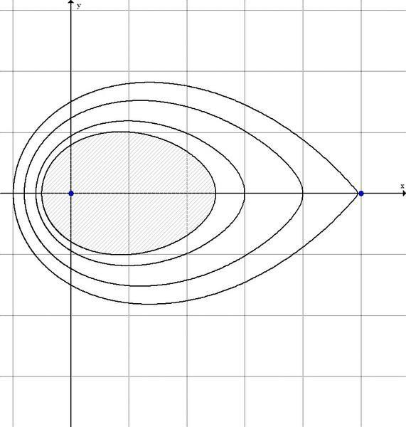

Here's some further analysis on the problem:
I'm changing the variables I use around a bit.
Now let [itex]R[/itex] be the distance to the boundary from the first focus and [itex]S[/itex] be the distance to the other focus. With initial values chosen on the optical axis.
Let [itex]\rho=\frac{\nu_1}{\nu_2}[/itex] be the ratios of indices of refraction and we can take it to be the index of refraction for the first medium taking the second medium as the vacuum.
We then define the values:
[tex]A = R_0+S_0[/tex] (total distance between foci)
and
[tex]B = \rho R_0+S_0[/tex] (optical distance = time of travel in c=1 units)
We have via equal time condition:
[tex]S+\rho R = B \to \quad S = B-\rho R[/tex]
and via law of cosine
[tex]S^2 = R^2 + A^2 -2AR\cos(\theta)[/tex]
Thence with some work we get the quadratic equation in R:
[tex](\rho^2 - 1)R^2 - 2(\rho B - A\cos(\theta)) R + B^2-A^2 = 0[/tex]
You can check that with [itex]\theta = 0[/itex] you get a solution [itex]R=R_0[/itex].
We can choose to use A as our scale factor (or pick A=1).
Define:
[tex]r = \frac{R}{A}, \beta = \frac{B}{A}[/tex]
thence
[tex](\rho^2 - 1)r^2 - 2(\rho \beta - \cos(\theta)) r + \beta^2-1 = 0[/tex]
Now consider the discriminant ( divided by 4):
[tex]\Delta = (\rho\beta - \cos(\theta) )^2 - (\rho^2-1)(\beta^2-1)[/tex]
[tex]= \rho^2\beta^2 - 2\rho\beta\cos(\theta) +\cos^2(\theta) -\rho^2\beta^2 + \rho^2+\beta^2 - 1[/tex]
[tex]= - 2\rho\beta\cos(\theta) +\cos^2(\theta) + \rho^2+\beta^2 - 1[/tex]
or
[tex]\Delta = \rho^2+\beta^2 - 2\rho\beta\cos(\theta) -\sin^2(\theta)[/tex]
[tex]r = \frac{\rho\beta - \cos(\theta)\pm\sqrt{\Delta}}{\rho^2 - 1}[/tex]
[tex]\beta = (\rho-1)r_0 + 1[/tex]
Note that at [itex]\theta=0[/itex] we get [itex]r=r_0[/itex] only if we choose [itex]\pm \to -[/itex].
Thus we have:
[tex]r = \frac{\rho\beta - \cos(\theta)-\sqrt{\Delta}}{\rho^2 - 1}[/tex]
[I've not triple checked this algebra but I think it's right.]
Taking typical glass, [itex]\rho=1.5[/itex] gives [itex]\beta = 0.5 r_0 + 1[/itex],
[tex]\Delta = 2.25+(0.5r_0+1)^2 - 4.5(0.5 r_0 + 1)\cos(\theta) -\sin^2(\theta)[/tex]
[tex]r = \frac{1.5(0.5r_0+1) - \cos(\theta)-\sqrt{\Delta}}{1.25}[/tex]
Attached are two sets of graphs. The second shows that as [itex]A\to\infty[/itex] we get nearly a spherical lens.

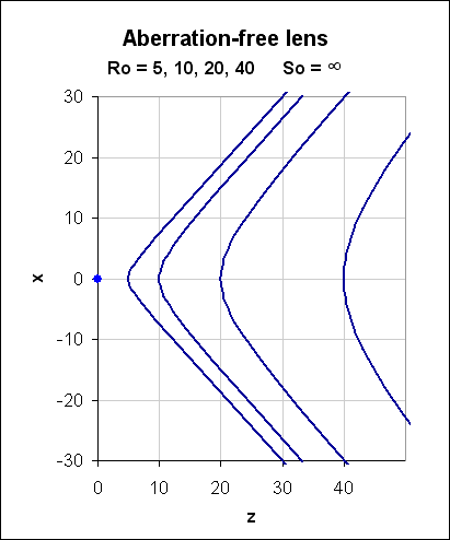

Your derivation (in post #22) looks right to me. I'd like to do a ray trace of a lens following your prescription, but it will have to wait as I'm busy with Holiday stuff this week and it is a little involved to define such a surface in my ray tracing code.
Ideally all rays that intersect the surface would converge to the same point, so that would be a good check of your analysis. It would also be interesting to see what aberrations arise for off-axis source points.

Well, something is bothering me now about these curves. I've entered the equations into Excel and reproduced the results from Post 22, but I am having the following issues:
1. For large enough angles (for example at theta 90 degrees), looking at the figures it seems such a ray cannot be refracted toward the image point.
2. When I reverse n1 and n2, so that the rays go from air into glass, I get a negative discriminant (Δ<0), and therefore no solution, for many values of theta. (Ro=100, So=10, rho=1/1.5)
I'll have to think about this some more to resolve these issues.
Mark
p.s. As A→∞ the surface appears to be an ellipse rather than a circle.
Mark
Yes, at the point were the line to the image point is tangent to the surface you transition to internal reflection. You could cook up an impractical 2-dim situation where you reflect while simultaneously transitioning to the the other medium. The actual lens would be defined for a restricted angle.
But a more practical application of this part of the surface may be that you interpret the foci as virtual foci in a compound lens system. I'll have to think about this some more.
Another note. One should also be able to work with virtual foci as well and build two half lenses which focus from point to point, or from infinity to a virtual focus with one half and then from that virtual focus to a true focal point with the second half.
Final note. I worked this out several times seldom without errors. Although I'm pretty confident I have it right I can't be 100% certain until I take more time to type-set the whole derivation and check it carefully by hand. With the holidays upcoming...
Re. 2.) This is the same as swapping foci so you should get the same curve about the other focus with then the angle limited to a range of values. You thus better not have positive discriminant for all angles. You will in fact get a better graph this way since it will only trace the part of the curve where you do indeed get actual refraction.
As far as the A→∞ limit, it is hard to visually distinguish ellipse and circle but I can't see how the eccentricity of this ellipse could be anything but zero in the limit. The form I have is not the best to look at this case. I'll have to work out a parallel derivation.
Oops! You were right. In the A→∞ limit you get an ellipse. I was thinking there were no parameters to specify the eccentricity but I forgot about the indices of refraction.
I got via quick calculation semi-radii of:
[tex]a = \frac{\rho}{\rho+1}, b=\sqrt{\frac{\rho-1}{\rho+1}}=\frac{\sqrt{\rho^2-1}}{\rho+1}[/tex]
(where [itex]r_0 = 1[/itex]).
Thus eccentricity:
[tex]e = \frac{\sqrt{\rho^2 -\rho+1}}{\rho}[/tex]
That's a first draft calc. so don't bet the farm on it.
