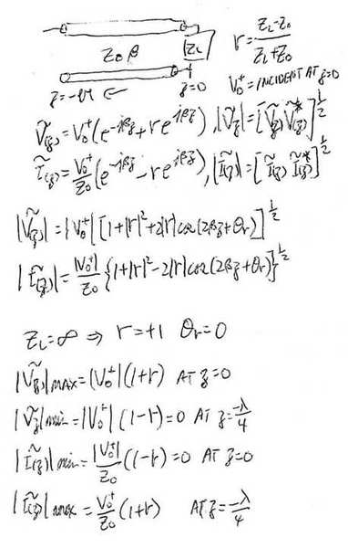

Hi all.
I have the following expression, which relates the incoming amplitude with the reflected amplitude at a point x = L in a coaxial cable:
[tex] A_{\text{reflected}} = \frac{R-Z_0}{R+Z_0}A_{\text{incoming}}.[/tex]
Here R is the resistance at the point x = L and Z0 is the characteristic impedance of the cable.
Lets say that I do not terminate the cable at point x = L, i.e. it is just left open. Then R = infinity, which gives me that [itex]A_{\text{reflected}}=A_{\text{incoming}}[/itex].
I know that the current I is zero at the point x=L (since the cable is left open, no current can run thorugh here), but how does this match up with the fact that [itex]A_{\text{reflected}}=A_{\text{incoming}}[/itex]?
Thanks in advance.Niles.

First of all, I forgot to mention that A is the amplitude of the voltage.
And second, my issue is that I can't see how a total reflection (without a phase change) of the voltage can make the current be zero in that point.

Current and voltage on the line are not in phase. If you look at the traveling voltage and current wave equation, there is a sign difference in the second term.
I think you better write out the equation to show where your question is so I can make sure I understand your question. Look at the standing wave pattern for open termination and see whether that help.
Ok, the amplitude of the reflected is related to the incoming voltage by:
[tex] V_{\text{reflected}} = \frac{R-Z_0}{R+Z_0}V_{\text{incoming}}.[/tex]
Thus when the cable just ends (no termination), we get that [itex]V_{\text{reflected}}=V_{\text{incoming}}[/itex]. So all voltage gets reflected without a phase change. How does one conclude from this that the current in the point where the voltage is reflected (i.e. at the point x = L, where the cable is ended) must be zero?

For this I have no choice but to go into traveling wave equation to get the amplitudes of voltage and current.
As you can see, the voltage max at the load end at z=0 and correspond to current equal 0. You need to think of the traveling wave is traveling with finite speed. The current has a different phase than the voltage because the sign on the second term is -ve. Hope that help.
read up the traveling wave and standing wave ratio in RF books, I have not seen any books that successfully described this in English yet. You just have to work with the equation to get the feel.

Thanks for taking the time to write all this down. Is there any way I can make you upload a larger image?
Thanks again, I really appreciate it.

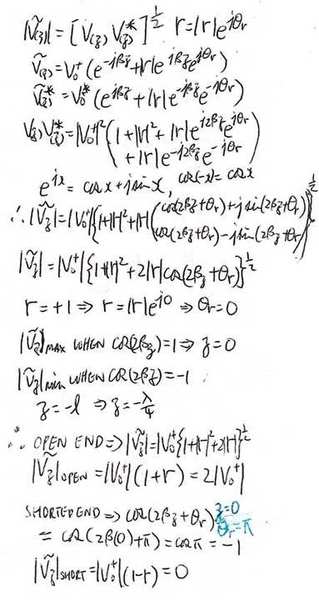

I updated the picture. Is this better. I want to make sure this is what you are looking for. If you have any more question on this, I am more than happy to elaborate the equations much further. I did skip a lot of in between steps to give you a quick and fast answer so far.
Is it exactly what I am asking for, but there are some steps in your derivation that I do not get; it is the part where you find |V| and |I|, and how you deduce |V|_max.
By the way, I will log of in not so long time (I must get some sleep), but I'll look here first thing tomorrow. Thanks so far.
Thanks! I understand it now; I really appreciate it!

Ahh, I should just look at your derivation.. at the point where the cable ends, the voltage is maximum.
It is a nice method you've taught me. Thanks again.

I update the original equations again. Read it over and see what you think.
Where are you? You go to sleep when I am wild awake!
It's great; I got the same results as you, but that's because I used your method.
