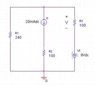

solve for voltage V with polarity as shown.
KCL - current into a node = current out
I tried to do nodal analysis using the top center node as v.
v/240 + (v-9)/100 - 20mA - v/100 = 0
=> v=26.4V
Obviously, I'm doing something wrong. Any tips to get me back on the right track?
I think current leaving the node is positive (+20mA) and the current through the middle resistor must be the same as that current source since it's the same wire
The top node is not at V.
The current through the middle leg is constrained to 20 ma however, and you know that the currents coming in the top must sum to 20 ma.
I1 + I2 = 20 ma.
Hence construct your Voltage loops.
I think that will resolve into the current I2 that you need to determine the voltage across R3.
I'm confused again. How do I solve for the i1 and i2?
sum of the voltages in a loop = 0, so for loop 1 with current i1 on the eft:
v1 + v2 = 0
i1*r1 + i1*r2 = 0
i1*240 + i1*100 = 0
loop 2 with current i2 on right:
v2 + v3 = 0
i2*r2 + i2*r3 = 0
i2*100 + i2*100 = 0
I know I'm not calculating the loops correctly, what am I doing wrong?
240Ω*I1 = 20ma*100Ω
9v + 100Ω*I2 = 20ma*100Ω
and as before
I1 + I2 = 20ma
What's going wrong now?
240Ω*I1 = 20ma*100Ω
==> I1 = (20mA*100Ω)/240Ω
I1 = 8.33mA
==> I2 = [(20mA*100Ω)-9]/100Ω
I2 = -70mA
I1 + I2 =/= 20
Here we go, I think I got it.
the two equations:
I1 - I2 = .02A (KCL top center node)
240I1 + 100I2 = 9V (KVL outer loop)
=> I1 = 20.59mA
=> I2 = 40.59mA
=> VR3 = I2 * R3 = 40.59 * 100 = 4.06V
