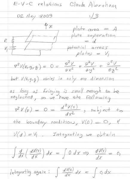

I worked this out, but I don't know where I stashed the sheet. I'll try to post it later tonight. The E = V/d is computed
by solving the Laplacian equation in 1 dimension, (del^2)V = 0 = Vxx + Vyy+ Vzz, where Vxx = (d^2)V/d(x^2), etc. In
1 dimension, x only, we have d2v/dx2 = 0. Integrating we obtain
dV/dx = c1. Integrating again we get V(x) = c1*x + c2. The boundary conditions are V(0) = 0 & V(d) = V1, so that V(0)
= 0 = c1*0 + c2 + c2, so that c2 = 0. Next V(d) = V1 = c1*d, which results in c1 = V1/d. Hence V(x) = (V1/d)*x.
Then for static charges we know that E = -grad V = -dV/dx. But dV/dx = -V1/d.
Hence |E| = V1/d. V1 = voltage on 1 plate with 0V on the other.
I'll attach a sheet later tonight.

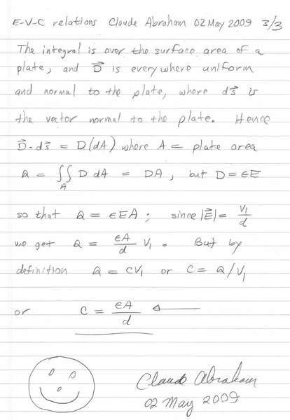

Here is the derivation using the Laplacian, and Gauss' law.
Claude
Thanks a lot man!:approve:
