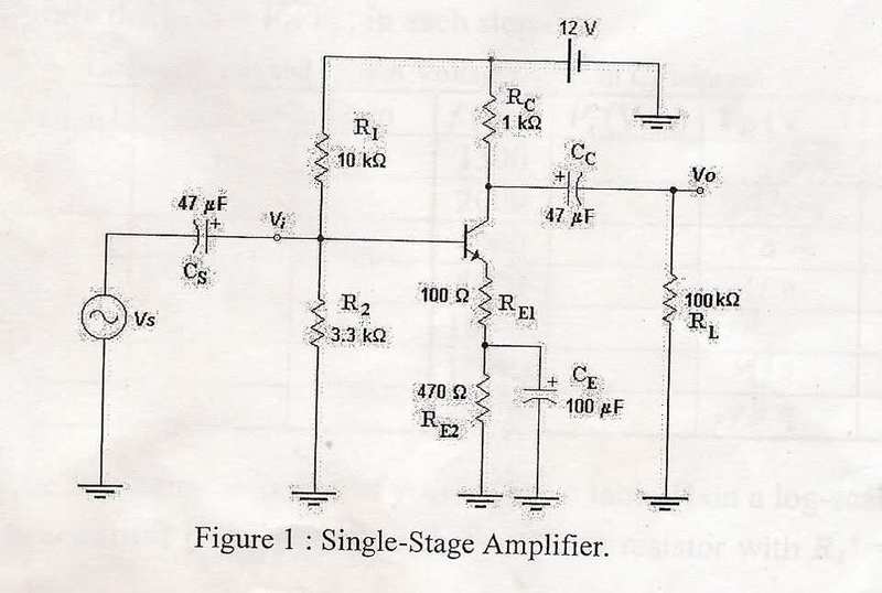

i did the lab and find all varible
but I can understand how find cut-off frequency
the question is
From you result in table Find the cut-off frequency
circuit figure
lab result
http://img19.imageshack.us/img19/6967/80959768.png
thanks so much in advance

The cutoff frequencies arethe frequencies where the gain is 3dB below the gain at the the middle frequencies.
Since your gain at middle frequency is 17.6 dB, you should extend your measurements below 20HZ and above 20kHz (probably several MHz), to find the cutoff frequencies.
