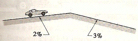

A car is rising an excerpt in slope of 2%, at a constant speed of 88,5 km/h.
If the driver does not change the motion, or changing the pressure of your foot on the accelerator, which should be the acceleration of the car down the stretch of 3%?Answer
0,491 m/s^2

It is:
I have a triangle of sides 2 and 100. Find the angle with the floor.
theta = 1,145
velocity x sin(theta) = 24,58 x sin(1,145) = 0,4911 m/s^2.
correct ? I did not use the slope of 3%
Your value for the angle of the incline (on the upward slope) is correct (edit: in degrees).
Your velocity in m/s looks wrong.
Your method also looks wrong. It makes no sense to get an acceleration by multiplying a velocity by a dimensionless number. Do you understand why this is wrong? vsin(theta) is meaningless here.

Hi Apprentice123! :smile:
Hint: on the upslope, the acceleration is zero …
so what is the force per mass? :wink:
Apprentice123 said:
I'm not asking you to resolve. I would like an explanation of the exercise
If the driver is moving at a constant speed, then a = 0. By Newton's second law, the net force on the car is zero. This means that
magnitude of forward force due to engine = magnitude of backward force due to weight. Therefore:
STEP 1: You can figure out how much force the engine is providing to drive the car upward.
Here, forward and backward are directions along the incline.
On the way down, the driver doesn't change the gas applied. Therefore, the force due to the engine is the same. This is the key to solving the problem.

Are you saying that:
Psin(theta) = m.a ?
I find a = 0,294 m/s^2
Apprentice123 said:
Psin(theta) = m.a ?
Sorry, I don't know what P is.
Component of weight parallel to plane = ma
EDIT: I don't get the same answer as you.
