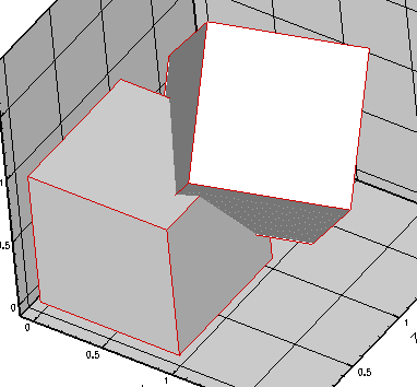

hi,
I need to find the points of intersection between two cubes, and the algorithm should give the intersection points even though my cubes are rotated in any direction. i need to know, Is there any general algorithm for this and what is the current research(any method) in finding the intersection of two cubes. the application where i am using is unstructured 3d mesh generation. Kindly help me to get a clear idea in this topic.

Imagine there are 2 cubes of same finite dimension. Example from 0 to 1 in all three axis. place the first cube with the origin (0,0,0), and place the second cube with the origin (0.5,0.5,0.5). So now both the cubes will get intersected with each other. I need to get the points where the edges of the cubes crosses the outer surface, we get six locations. (just think in 2d to get more clear). Still find problem in my question have ur post.
A 'cube' type thing is just described by a1<=x<=a2, b1<=y<=b2, c1<=z<=c2. To intersect two of them just figure out how to intersect two segments in each of the coordinate axes.

Cube of edge length 1 at origin (0,0,0), described by -1/2<=x<=1/2 etc. Same at origin (1/2,1/2,1/2) described by 0<=x<=1, etc. Intersection, 0<=x<=1/2, etc.

1) I think from the attached figure you will be able to get my question.
2) the red lines in one cube will cut the outer surface of other cube. I need to find the location where the edge(red line) cuts the outer face.(six points will occur! am i rite). Is there any algorithm used for this. and what are the ways it can be done.
3)the algorithm should be more general way where any degree rotation should give me the intersection points. I tried a way where my algorithm fails to locate the points if other cube is rotated more than 90 degree..

Just break it up into a finite 3-d grid, and for each cube, decide which grid cubes are filled by the larger cube. Then see which grid-cubes are filled by each of the larger cubes simultaneously, and keep these. This is the intersection.
This method does not offer infinite precision, but it is general and will offer a (relativelty) arbitrary precision.
