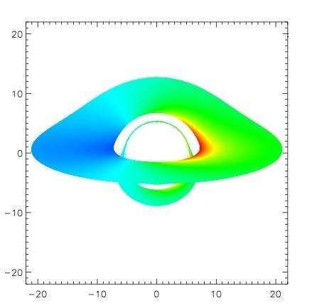

Thank you George and stevebd1,
It is true that these expressions are only valid for an observer at infinity. You are right George, neither is what I'm truly interested in. As you know from my previous thread, I'm imaging accretion discs (and tori) around Kerr black holes. It's easier if I explain what I am doing before I ask a question, so as to have some idea of context. I apologize for the inevitable length of this post.
First of all, redshift is defined by ([tex]E=h\nu[/tex]):
[tex](1+z)=\frac{\nu_{0}}{\nu}=\frac{(p_{\beta}u^{\beta})_{\lambda}}{(p_{\alpha}u^{\alpha})_{\infty}}[/tex].
For an (stationary) observer at infinity, or in the case I am working with, at say 200 gravitational radii from the black hole centre, [tex]u^{r},u^{\theta}[/tex] and [tex]u^{\phi}[/tex] are all zero, hence the only contribution is [tex]p_{t}\dot{t}[/tex]. Also, [tex]\dot{t}_{obs}[/tex] is determined in the initial conditions, and [tex]p_{t}\equiv -E[/tex], which is also computed in the initial conditions (and is constant).
I have no problem in finding the redshift of an observer relative to emission from a material particle on the disc surface: We simply find the components of the four-velocity of a point on the disc. The flow is rotationally supported in the [tex]\hat{r}[/tex] and [tex]\hat{\theta}[/tex] directions, thus [tex]\dot{r}[/tex] and [tex]\dot{\theta}[/tex] are zero. One also finds expressions for [tex]\dot{t}[/tex] and [tex]\dot{\phi}[/tex], but I won't list them here (quite long).
I take the disc as lying in the equatorial plane, so setting [tex]\theta=\pi/2[/tex] simplifies the expressions considerably. With [tex]E_{em(disc)}=p_{t}u^{t}+p_{\phi}u^{\phi}=p_{t}u^{t}\Big(1+\Omega_{k}\frac{p_{\phi}}{p_{t}} \Big)=p_{t}u^{t}\Big(1-\Omega_{k}\frac{L}{E} \Big)=p_{t}\dot{t}_{em(disc)}\Big(1-\Omega_{k}\frac{L}{E} \Big)[/tex] ,
[tex]E_{obs}=p_{t}\dot{t}_{obs}[/tex],
we find the redshift of the observer relative to disc emission as
[tex](1+z)=\frac{\dot{t}_{em}}{\dot{t}_{obs}}\Big(1-\Omega_{k}\frac{L}{E} \Big)[/tex] , where
[tex]\Omega_{k}=(r^{3/2}+a)^{-1}[/tex] and [tex]\dot{t}_{em}=\bigg(\Omega_{k}\sqrt{r}\sqrt{r^{2}-3r+2a\sqrt{r}}\bigg)^{-1}[/tex].
I've included a redshift map of a Schwarzschild accretion disc, viewed at an angle of 75 degrees from the vertical. You can see the features I mention in my previous post.
In reality I'm beyond this and am now looking at solving the local G.R. radiative transfer equation:
[tex]\frac{d\textit{I}}{ds}=-\chi \textit{I}+\eta \Big(\frac{\nu_{0}}{\nu}\Big)^{3}[/tex], where
[tex]\textit{I}=I/\nu^{3}[/tex], [tex]\chi = \frac{\nu_{0}}{\nu}\chi_{0}[/tex] and [tex]\eta=(\nu/\nu_{0})^{2}\eta_{0}[/tex]; observer - no subscript, local frame - sunscript '0'.
I must solve the transfer equation once I have computed the geodesic for a photon (I'm looking to plot intensity maps and eventually spectra). My problem is how do I find the redshift [tex]\nu_{0}/\nu[/tex] of a photon at each point along its path ([tex]\small{ds}[/tex]) after disc emission relative to the observer, who is not an infinite distance away.
I'm having problems with this because, photons are null geodesics, so [tex]p_{\beta}u^{\beta}\equiv 2\textsl{H}[/tex], the Hamiltonian, which is zero for photons. This means the redshift after emission from the disc to the observer, at each point along the geodesic is zero (well, (1+z)=0, due to energy conservation)?
How does one find the redshift of the photon at each point along its geodesic path back to the observer, relative to this observer, if said observer is a finite distance from the black hole?
