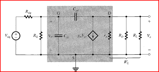

Reading the voltage taken at the output, Vo.
Resistors in parallel carry the same voltage.
The circuit shown in the diagram, the output is taken directly in parallel with Ro, so shouldn't that mean that:
VRL = VRD = Vro ?
In calculating the output, they combine all those 3 resistors in parallel into RL', I don't understand why.
In other words, why doesn't Vo = VRL ?

The output voltage is indeed the voltage across those three parallel resistor components. It doesn't matter if they are drawn as 3 resistors or the equivalent single resistor, unless some individual current is needed for some other part of the model calculation.
I might be repeating the above post:
VRL = VRD = Vro ?
Yes
You don't know the voltage across either of those three. But the total current passing through all three resistors is g_m*V_gs which is known as I am assuming. You can go solve the circuit in either way: it's a simple circuit with three resistors in parallel and one current source. Simplest possible method is to combine all three ll resistors and find the voltage.
