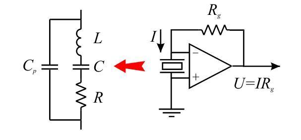

When i tried to find V_o(s)/V_i(s), i got a transfer function in s domain as,
degree of denominator was greater than that of numerator.
please help me find the transfer function of the attached circuit. i eventually need to find the impulse response.

I'm not sure (the problem statement schematic is a bit unusual for me), but I think Vi should be at V- input, and the other side of the xtal is grounded (connected to V+ input). Vi is not being fed in through the xtal. Does that give you a better result?
Vi is connected through the RLC circuit parallel with C_p. Attached is the other equivalent of the circuit. I hope that gives a better idea of the circuit i am trying to analyze. The schematic diagram seems correct according to this attachment. I do not know whether it gives a better result. I have just been asked to find the impulse response. so i was trying to evaluate the transfer function first.
