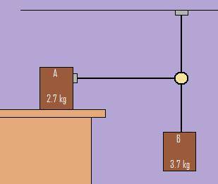

Question 1) Block A and B are connected by a string passing an essentially frictionless pulley. When the blocks are in motion, Block A experiences a force of kinetic friction of magnitude 5.7N. If Ma= 2.7kg and Mb=3.7kg, calculate the magnitude of
a) The acceleration of the blocks
b) The tension in the string.

Your question gives inadequate information, whether blocks are on a table or not. But from the available data, it is reasonable to assume that block A is on a table, block B is hanging around the pulley - those are my assumptions.
Under my assumptions, look at the block A first. There is friction(f) and tension(T) in the string. This gives: T - f = Ma*a ___________ 1
Again, look at the block B. There is its weight, Mb*g and tension. This gives:
Mb*g - T = Mb*a __________ 2
Here the two tensions for A and B are equal because the pulley has no friction and acceleration of A and B are equal because they move together - there is no relative velocity between those two.
Solving 1 and 2 gives both tension and acceleration.

Hello, Thank you SOO mch for your reply! I am very sorry for my poor discription. And yes, you're right. The block A is on the table. However, I don't understand how i can get the acceleration by using (MB)(g)-T=(MB)(A) because i don't know both Acceleration and the Tension. The texbook says the Answers are:
A) 4.8m/s*2
B) 19N
but I don't know how you got them.

In the first eq, you know friction and mass of A. For the second eq, you know mass of B and g. This gives you a two simultaneous eq's in two unknowns which I think is easy enough to solve. You have two eq's, not one.
I got them by separately using Newton's second law for each block.
net force = mass times acceleration
Hello, Thanks again for your reply! I tried for A) using (MB)(g)-T=(MB)(A)
(3.7)(9.8)down-(5.7)=(3.7)(a) to (3.7)(9.8)/(3.7) - 5.7 Since 3.7 cancel, I am left with 9.8-5.7 but that doesn't give me 4.8 m/s*2 , it gives me 4.1
hi there again,
T - f = Ma*a __________ 1
Mb*g - T = Mb*a ______ 2
Add 1 and 2, you get: Mb*g - f = (Ma + Mb)a
Plug in everything except a, and you get exactly 4.775
Plug in the value of a in any of the two eq's.
