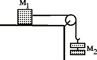

M1 has a mass of 6.51 kg. It is on a horizontal surface, connected by a light string to a hook. Mass M2 can be increased smoothly by adding masses little at a time. The pulley has a negligible mass and no friction.
When M2 is 3.12 kg it begins to accelerate downwards at a rate of 1.52 m/s2. Calculate mu static -mu kinetic for M1 on the surface.
I was also given this hint, First calculate ms (from knowing the force it takes to begin moving) and then mk (from the given acceleration) and subtract
F= Ma
Mass2
Fnety = T-Mg
Mass1
Fnetx= T-Fstatic
Fs= Mus*Fn
Fk= Muk* FN
Mass2
Fnety = T-Mg
-4.74N= T-30.576N
T= 25.83
Mass1
Fnetx= T-Fkinetic
9.89N= 25.83-15.934
Fk= Muk*Fn
15.9348/63.798= 25.83
Muk= .24976
Fnet=0
T-Fs=
25.83
Fs= Mus* FN
25.836= Mus * FN
25.836/63.798
Mus=.405
Mus-Muk= .155

There is something odd about this solution and I can't quite pin it down. I think you are supposed to write F = ma for each mass as your starting point. This would give you 2 equations:
[1] T - u*m1*g = m1*a and [2] m2*g - T = m2*a
where T is the tension in the string between the two masses.
When a = 0, you get T = u*m1*g from [1] and when you put it into [2] you have m2*g = u*m1*g which gives u = m2/m1 = 0.479 for the static coefficient.
