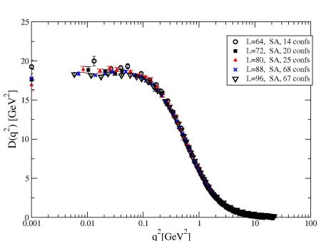

humanino said:
This is shown in the flattening of the propagator in this lattice calculation for instance
blog page
The Infrared Behavior of QCD Green's Functions
Precisely because gluons are (nakedely) massless but might create (very) massive (pure) glueballs, and because this is relevant to more than 95% of our own body mass, it seems intuitive that the Clay prize is actually interesting.
From the graph it looks like the mass is around 4 GeV.
How can one say that gluons account for 95% of our body mass? Take the example of a pion. A pion is a condensate of a composite quark/antiquark field, and when you give mass to the quarks, the pion acquires a mass. If quarks have zero mass, pions have zero mass (the chiral symmetry would be exact). A proton is made of 3 quarks, but the formula for the proton mass is much more indirect than the formula for the pion mass: in order to calculate the proton mass, you have to calculate the amplitude for nucleon-nucleon scattering, and this can be theoretically related to the mass of the nucleon. Gluons do not seem to be appear anywhere however when it comes to hadrons - the baryons are made of quarks, and so are the exchanged particle, so how do gluons come into play?
Gauge symmetry forbids the renormalization of the gluon (or, for that matter, photon) mass away from 0. What the plot is showing has to do with binding energy in physical states.
