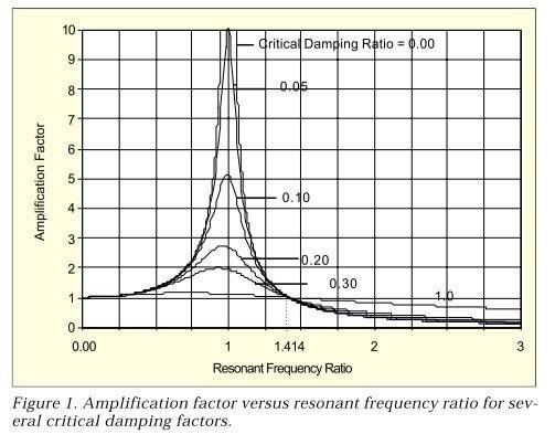

Short answer...it will probably change the frequency slightly as shown by the attached plots:
From a description of tuned isolator dampeners:
http://www.newport.com/images/web150w-EN/images/1310919.gif
ref: http://www.newport.com/Optics-Based-ResearchThe-Need-for-Vibration-Isola/139774/1033/catalog.aspx
The other attached image is of amplification factor vs. resonant frequency ratio for a simple forced vibration system.
In both, you can see that resonance changes very slightly for varying dampening.
