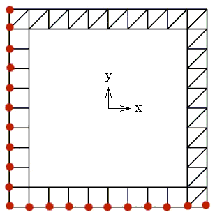

Hi,
I am a PhD student in math and in my current research I'm faced with the problem of analyzing the rigidity of a structure of rigid beams in 3D, that is if the structure can move. In particular, something like this:
http://img525.imageshack.us/img525/1545/98322092.th.jpg
where all the lower and left lines vertices are fixed. It is thus clear that the row and column formed by little squares are rigid, and the same is true for the bottom-right and the upper-left triangles. However, it seems that this structure is not rigid in 3D since is possible to move the upper-right pair of triangles along the diagonal of the big square by "folding" the little square they form.
Is there a way to choose the orientation of the triangles such that the structure cannot move? Is there a theory I can refer to in order to understand this? 2D is very easy, but the counting of degrees of freedom seems different in 3D, if possible at all when the structure has the topology of a surface.

Can you draw on your diagram the boundary conditions (constraints)? I.e., show which degrees of freedom are rigidly fixed to the outside world. Secondly, are the joints of all members pinned or welded? If pinned, are they pinned only on certain axes, or on all three axes (which would be a ball joint)? I didn't follow your comment about folding. Maybe if you label some key points, it would be easier to refer to certain points or lines in your description (?). In 3-D, there can be up to six degrees of freedom per node.
Thanks for the reply. Sorry for having been sloppy, but I'm not used with terminology and notations of this field.
The joints leave 2 axes free, that is they do not allow for a rotation having the truss as axis. Here is the upgraded diagram, where red dots are fixed dofs:

OK now that you clarified this, it's also clear that I was assigning wrong dofs. The question "I'm still not fully convinced, though, that an infinitesimally thin truss should have 3 rotations, and not 2" was motivated by my attempt to put frames at nodes, having thus 6 dofs, and to say that a single member should not be allowed to rotate along itself, to reduce the total dofs for a single truss. But your approach and explanation have cleared my ideas.
So, coming back to the original question, is it possible to say if the structure is rigid? And if not, is it possible to change the orientation of some members in order to make it rigid? Thank you again for the patience.

This basically lookis like a numerical FEA problem to me.
If this framework is being modeled in 3-D using spar elements, it is true that the end-points for each spar will only have 3 degrees of freedom, translations in X,Y, and Z. However, if each element is modeled as a beam element rather than a simple spar, them it is possible to incorporate 6 degrees of reedom in each node, translation in X, Y, and Z, and Rotation about X, Y, and Z. Which element you use will depend on the purpose of the model.

You will have to define what you mean by rigid in the first place. If by rigid you mean fully constrained, that can be determined by looking at the number of nodal degrees of freedom and constraints available in your system. If the connections are only modeled as spar connections, that means they have zero bending stiffness, and are only able to take tension or compression, and cannot be constrained in bending.
To determine if the structure is fully constrained, you will need to take all of your degrees of freedom (72 nodes times 3 DOF each), subtract the fixed degrees of freedom (21 nodes times 3 fixed DOF each), and subtract 1 DOF for each side of a spar that is attached to an unfixed node (51 nodes times 3 spars each). The result of this is 216 total nodal degrees of freedom, minus 63 fixed boundary condition DOF, minus 153 degrees of freedom constrained by attached spars. This results in 0 left over degrees of freedom, which seems to indicate to me that the structure is fully constrained, although it's a little difficult to visualize.
