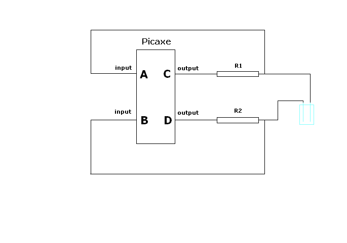

I am a ecologist and I have been playing around with a water conductivity sensor, however in seawater there is the obvious oxidation issue. I have found that with the right correction factors and with the polarity frequently reversed, the electrodes have reasonable accuracy.
The Question: Is there an crossover circuit, that can be controlled by a microcontroller, that would allow the power circuits to be flipped. I am running 5v DC.

I would use a double pole double throw(DPDT) relay and a driving timer circuit.
You could use something like the attached diagram.
Two outputs of a Micro are used and they are alternately sent to 5 volts while the other is kept low. To the water sample, this would look like AC.
The outputs are fed back to A to D converting inputs (A and B ) where readings of voltage are obtained. The voltage depends on the conductivity of the sample and the values of the series resistors R1 and R2.
One advantage of using a micro like this is that the output voltages only need to be present for the very short time it takes to do an A to D conversion. Maybe 2 or 3 milliseconds.
The probes could have no voltage at all on them for the rest of the time.
So, if you only took a reading every second or so, the the voltage would only be present for about 0.3% of the time.
This and the alternating voltages would limit Chlorine production and corrosion of the probes.
I have mentioned the Picaxe chip, but any Micro you are familiar with could probably be used like this.

I'm giving the microcontroller a try, and so far it looks promising. The problem that i ran into was the pwm analog outputs don't provide a proper voltage signal for a dc sensor. The solution i have on the bench now is similar to the schematic from vk6kro but with the outputs fed into pair of 556 chips as pulse generators.
In this setup i can feed the chips a conditioned 5vdc source.
Any obvious flaws in this setup?

Whatever works is fine, but I don't understand why the Micro couldn't give you suitable PWM out. The Picaxe chips will give 0% to 100% PWM in 1024 steps. This can be used as is to drive a meter or filtered to give actual DC out.
All outputs can send Ascii text to a serial port of a computer or a serial LCD, if you wanted to go that way.
The Picaxe chips need 5 volts and preferably a clean regulated 5 volts.
The actual readout for this would come from a different output, not the ones connected to the water sample. A picaxe 14 has 6 outputs. A 20 M has 8 outputs.
So, you would use the circuit above to get a reading on the A to D inputs of the chip and then do any calculations and present the output to one of the other outputs.
The high resolution input A to D command for a Picaxe is
readadc10 4, w1
where it is reading from input pin 4 and the reading is put into a variable W1. W1 would be a number between 0 and 1023 where each step would be about 5 mV. (Pin numbers are just examples).

I am using two analog outputs and two analog inputs connected to the electrode and using a serial connection to output the data. The problem I had using the pwm was that the voltage signal coming from the analogue output is a square wave. The square wave was was picked up exactly as transmitted (though slightly attenuated by the voltage drop across the sample) by the analog input. So you can image the the displayed values being of the nature:

It seems like you have a continuous pulse stream going to the electrodes? Why?
I would do this:
send one output of the Micro high and keep the other one low.
read the ADC inputs
Send the high output low.
wait one second
send the other output high and keep the first one low
read the ADC inputs
wait one second.
Now, you want an average of the high readings from both inputs and an average of the low readings from both inputs.
Subtract these to get conductivity data which will depend on the series resistors.
