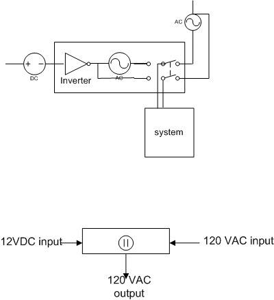

Greetings,
I would like to build a circuit that would switch 2 separate AC power sources to a single load.
Here's what the circuit should do:
Circuit has single AC output to a system which utilizes AC current
Circuit has both a 120 VAC and 12 VDC input. 12VDC circuit is connected to an inverter circuit to produce a separate 120 VAC input.
In the event AC current is present in the AC input source, switch the circuit to source the load with the AC input
Switch the circuit to the 12VDC/inverter input if the AC input current is not present
Power requirement is for the output is 150 watts
So basically, the 12VDC from the input goes through an inverter circuit to produce the first AC source, a separate AC input connects directly to a 120VAC source to produce the second AC source, and a switch or relay switches the first or second AC source depending on the conditions listed above. I have enclosed a jpeg image to better illustrate what I am saying. In this diagram is a DPDT switch which would allow manual switching but my intent is to use a relay to provide this functionality. My question is if there is a relay that would perform the function of the switch and if so how would it be connected? Specifically, can I use the AC voltage from the second input source to drive the relay? Thanks in advance for your help.

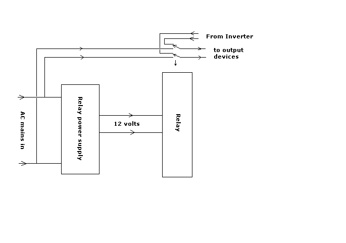

If you just wanted to switch to mains power when it was available, you could use something like the attached diagram.
The mains power would be used to pull in a relay when it was available. This would switch the load to the mains as shown.
Not shown, but probably necessary, is that the power to the inverter could also be switched with another set of contacts on the relay. This would cut the standby current of the inverter to zero when mains power was being used.

But beware of current surges if the load is inductive, and the ac phases of the inverter output and mains don't match.
