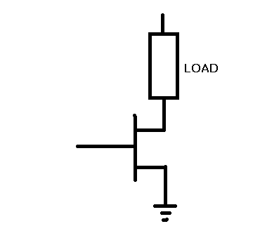

In the following circuit,
Can you see that if the FET is ON, there will be very little voltage across it, so this multiplied by the current results in very little power.
If the FET is OFF, there will be maximum voltage across the FET but no current, so the power will be zero or very low.
It is only when the FET is turning ON and turning OFF that there can be a large product of voltage and current. If this takes a long time, it can result in heating of the FET.
